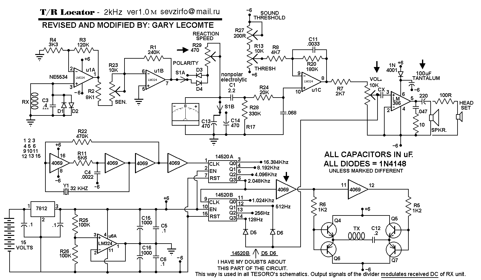

      hi All. I did revise Gary's schematic, my viewpoint you will note there. I hope now schematic is clear.
      TOO SMALL, I Can't read the Writing you put on that schematic.
      Also Not sure Why you added the other section of the 4069.
      Does it need to be there to Invert the signal?
      ** PLEASE Let me Know, before I go any further.

      • sorry, I attached full sized image, but it was reduced. PNG is limited on 19,5 kB on the forum
        one invertor is free and I think it will be used for current loading reduce of divider output, not for to invert the signal. it's more logically in similar schematic to use buffers, ordinary thing. althought in original view the device is working well.

          Yes I understand that, But its also Missing Many Traces.
          OK, I added in that extra stage, But I sill have doubts on it. But its easy to Remove parts to try it Both Ways.
          I Also Updated my Schematic with a few other changes.
          I Really dont understand, Why Such a Size Limitation on a PNG File on this site.

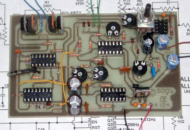

                Curious, Why do we need a Layout on Sprint software?
                I will Post the Final PCB and Layout.
                Anyway, Here is a Picture of the Assembled PCB I made.
                Need to make some coils now, but first need to find the data for them, Than test the board.
                Anyone Interested in a Free PCB for this?
                Once I am sure the board is Correct, I'll create another Post to get Names of persons interested.
                Than I'll put those names in a Hat and give one away to the person whose name I draw.
                Take care...Gary
                • the PCB is absolutely toppingly, Gary! but one thing we did lose, IMO. we must think about a stability. on PCB must be set up smoothing capacitors, 0,1-0,15-0,22 uF. I think one on 4069 and 14520 power supply pins, between +6 and -6 or two between (+6 -- GND) (-6 -- GND). also these capacitors on the opamp supply pins. maybe also to add smoothing chokies in TX driver supply -? I yet do not aware that it is strongly actually for this device or not...
                  regards.
                  • TR locator
                    Hi Gary and congratulations on that nice PCB and circuit.
                    Well i post that sprint layout file, because may be someone with this software can find easy to made the pcb from this software. Has i said i m not very skilled with electronics, and for me is easy to print directily from the software that i have to the laser printer. Then i just have to ironing the circuit on the pcb and finally place the board on the copper remover.
                    But anyway if your final work shows me that is easier to transfer the image for ironing on pcb thats ok.
                    Many thanks Gary for nice job, and of course i m Interested in a Free PCB.
                    Nelson

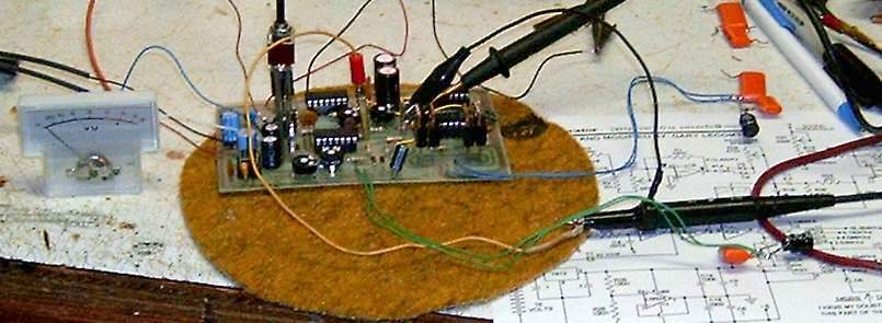

                      Here is a picture of the Circuit in Operation.
                      Notice my Two BIG Black Coils on the Right hand side.
                      (each are 1/2 inch diameter and 3/4 inch long)
                      Easily Detects a piece of metal at 8 Inches on the meter.
                      These Coils are 15 Mhy, Which is what the Full Size coils should be.
                      No Audio Yet, Small Probem there.
                      But Transmitter and Reciever circuits are all OK, right through to the meter.
                      KT315: There appears to be No Filtering Problem.
                      Nelson: I can make boards for anyone, If Needed.
                      Anyway, More to Come, Probably Tomorrow or Sunday.
                      Got other stuff to do today
                      • my congratulations sir chemelec, you work is pretty and professional
                        these audio of lm324 amplifier, is very dificultous, like is possible whit complementaries 547 & 557 transistores, or similar
                        detectoman

                          • Originally posted by detectoman View Post
                            detectoman
                            Thats why I am a Professional Analogue Designer, but Retired! Just a hobby now.
                            There is No Problem with the LM324, it is all functioning correctly according to my Scope measurements.
                            But Possibly I have a trace Wrong, somewhere in there.
                            I Will check that out tomorrow.
                            (Going Bug Eyed Today.)
                            Complementry Transistors are also simple stuff.
                            I used TIP31C and TIP32C Transistors for the Coil Drive.
                            They are also working correctly.
                            Those "BC" Numbers, such as 557, 558 and so on Transistors are Not very common in North America.
                            But these transistors aren't critical in this circuit.
                            I could even do this up in surface mount, (Really Tiny) but my eyes aren't that good anymore, for that type of assembly.
                            Hope you all like my Recieve and Transmit Coils!
                            I am not prepared to make the proper coils as I have no use for this detector, so actual test results will be up to those persons that build it.
                            My proto just gets Scrapped later.
                            But I Should have a Completed PCB and Schematic Soon, And I will Post it all.
