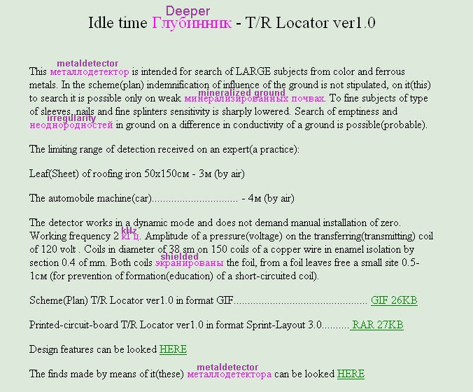

contrary, with CLOSED shield you will get like to a transformer with CLOSED ONE LOOP. so ALL E-M ENERGY will be transfer in a HEAT
a lot of years ago, not now
