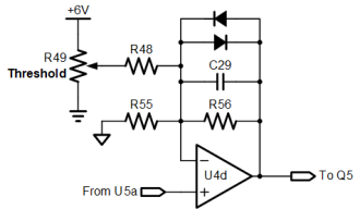

                  • Any One
                    is it Possible To add a Retune/Tune/Reset Button
                    to Any Existing 2 Box Like Gemini TW6 Metrotech Detectron Goldak
                    The Main Disadvantage I See with this device is the mineralization
                    on Bad Ground a Device like Whites tm600 tm808 and Garrett Eagle Eye seems to perform better because of the Ground Balance
                    • Short answer is 'yes'. Long answer will take me a little longer to devise. I'll follow up later.
                      • This is valid for the TW6 & Gemini 3, which are identical designs. Probably also the Detectron 505, which appears to be a copy of the TW6.
                        There is a final amp stage which has the Threshold control:
                        You can add replace the Threshold control with an autotune circuit like this:
                        ​​Click image for larger version
                        It is absolutely critical that the new opamp has an ultra-low IB spec to avoid drift, I would use a CMOS-input opamp. I put in some startnig values for some components but they will need some figuring out. Increasing the 1u cap will help with drift. You may need to add outboard resistors to R49 to restrict the voltage range, I don't know for sure. R48a-b will also have to be figured out, I would set R48a = 1k and then work on R48b.
                        Before modding the circuit the first thing I would do is measure the DC output for U4d for the entire range of R49. You want the new circuit to reasonably match this.
