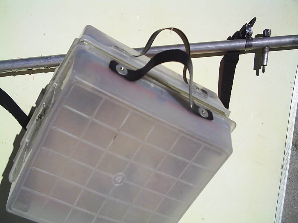

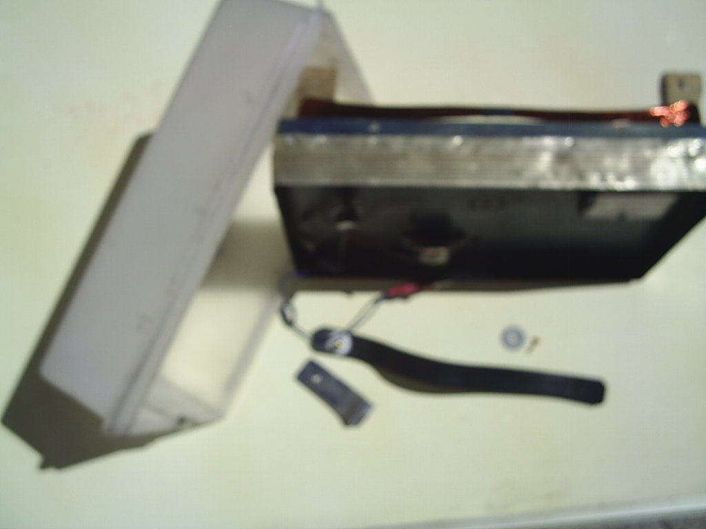

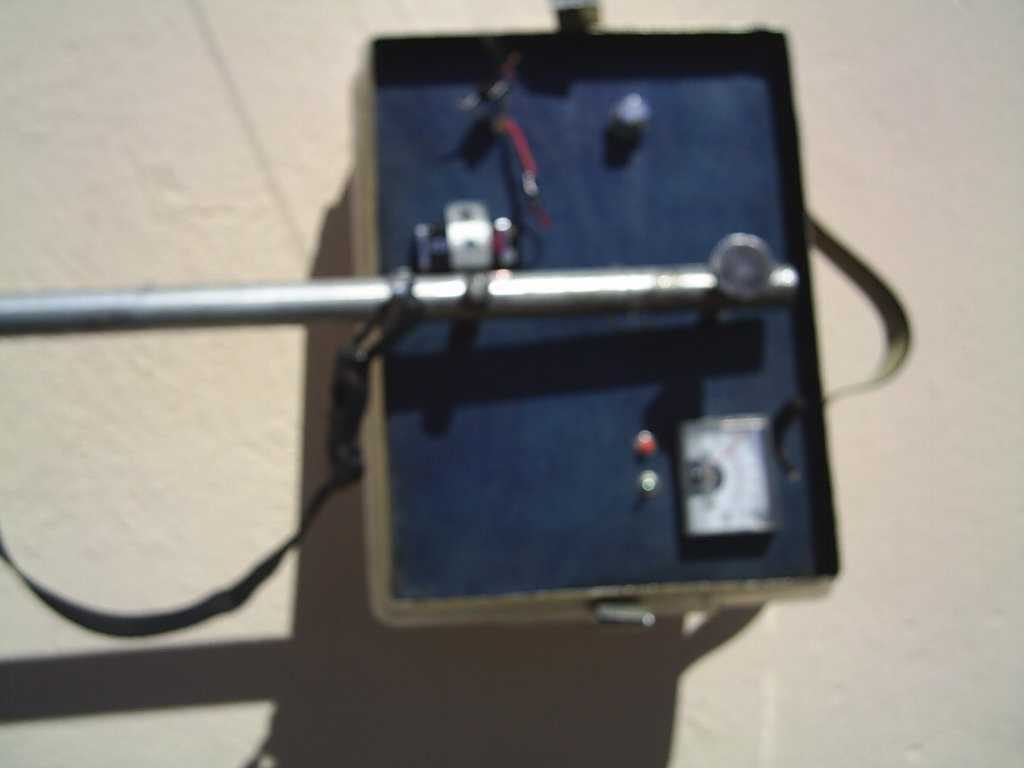

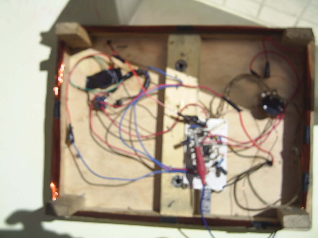

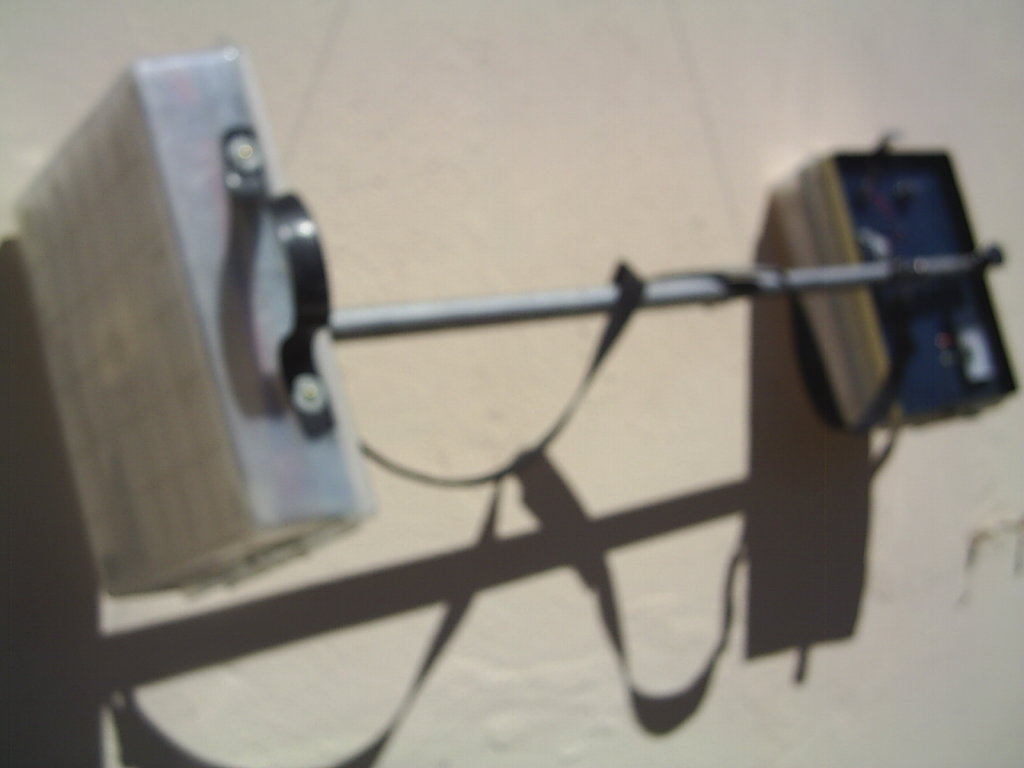

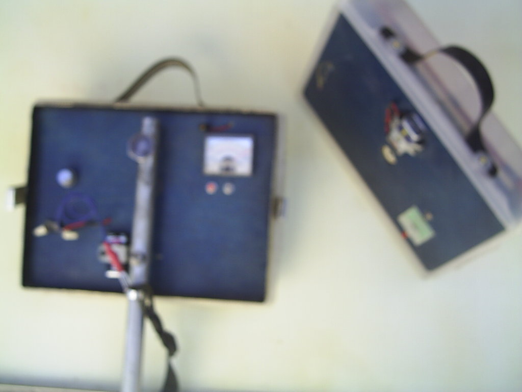

      unas fotos de mi primer dos cajas que construi
      hello brothers i show in society , to yours my first two boxs these detector previous i probe only two times, if effective on one depp of one meter has sucess , is pending other test is very stable
      is work whit one battery 9 v each box
      the circuits is similar of svfiro and other owns modifications, and distincts functions of visual signal, these my two box face a face tx and tr in air reciver own signal to four meters
      best regards to groups of members detectorist
      detectoman

        Hi detectoman. Bravo good work.
        1. But as i see you must use short wires.Change the position of components so the connecting wires to be short.
        2. Put the receiver pcb near the rx coil. The coil should be connected directly in pcb.
        3. Try for better balance between coils so to give higher gain. With coils face to face you must receive the tx signal at 20 feet at least.

          thanks for yours words to my, you have true reason, you,re experimented man, my congratulations, is veracity .,the large wires cause vibrations and instability, my detector is only experimental ,is my fhirst project,two box,is stable and the circuit is very short similar in comparationm whit svfiro, is not copy of svfiro , the circuit is design from of my investigation

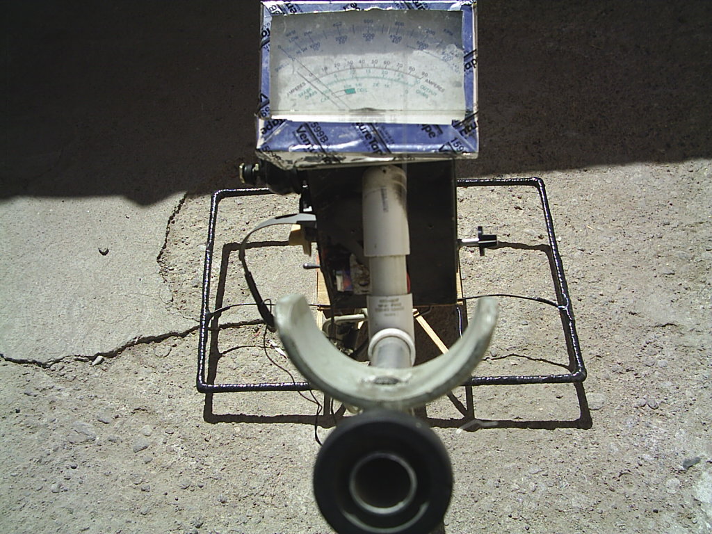

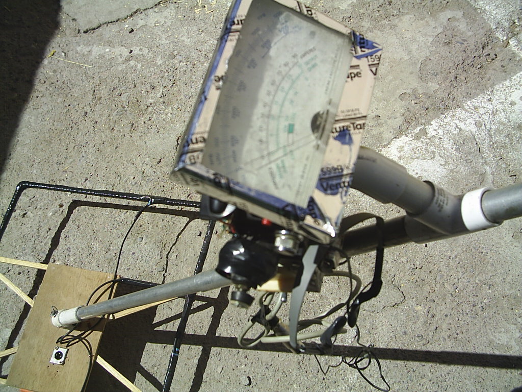

            here other project of my one bfo
            this my bfo i modified, i nedd one effective shield for he, this bfo is very sensitive, deep in soil, of stones, 1.50m , whit sound of motorboat and sound silent, i like convert this circuit to discriminate , in other chasis , i am project this modifications , in future

                That is one big coil for a BFO. I thot the BFO was a thing of the past. Would you please provide the modified schematic that you used. 1.5 Meter depth is impressive. I have digital signal processing background. Maybe you could use a PIC microcontroller for discrimination.
                Do hot rocks and highly mineralized soil mess up the detectability?

                    friend goldfinger, mi schematic is the circuit refered in the panel of faraday shield , is the link of home clara , of six transistors, these y modified , i little, whit cap, of 100n and 100v, in the oscilators reference i put , 2n2222 and, induction coil big of 65 x40 cms, square, one detector whit deep power of 1,50 m is not one toy, is one project of my investigation, for competence whit others modern, i am very interesting in bfo for your economy and are simple, my problem is the extremely sentitivity and refect of capacitance whit ground, if i resolve this problem, my bfo is most actuality how pi or ib , i am apliqued too install one circuit for discrimination, in the future, whit pass band filters or other tegnics i think , is only one project for new born of these versatiles detectors, economical
                    excusme for my english , i no send diagrams internal of these bfo , they are very basics i am worry your see my work of beginer this is not pretty, how important is your function ok
                    regards goldfinger detectoman mexico
