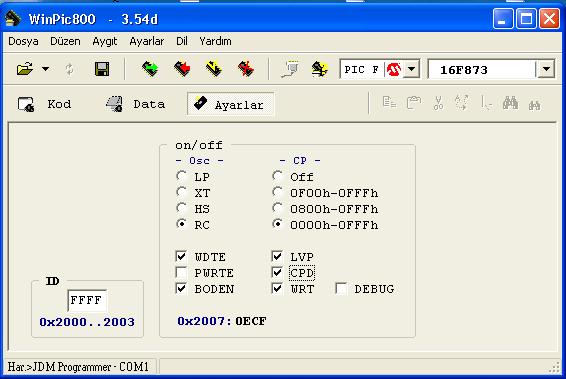

    Hello.How are you.If you help me,I will be glad.How can I make CP protection. Is it right.Thank you for your helping.Regards.

    processor 16F873
    #include <P16F873.INC>
    __config 0x3F72
    ; _CP_ON & _DEBUG_ON & _WRT_ON & _CPD_ON & _LVP_ON & _BODEN_ON & _PWRTE_ON & _WDT_ON
    ; & _HS_OSC

      Hi kt351, I’m not sure which way this question was meant as I interpreted it as
      Will these settings protect the code in my 16F873
      If that was the way it was meant then Yes it will protect the code.
