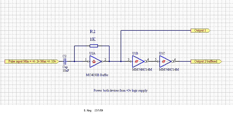

    Anyone know of a way to shift a -10v to 0v pulse to a 0v to 5v pulse. I have converted a 555 PI detector to a PIC driven detector with current capability to detect a 1 OZ gold coin at 3 feet in the air. I want to run the signal into another PIC to do some DSP and increase the depth detectability. I have scoured the opto-isolators and they all require about 1.5 volt input and obviously I am about 10x too high. Another possibility is to reduce the signal level. Or redesign the output section which I am loath to do.

    If you are looking to shift transmit pulse signals from -10 to +5v/0v then perhaps this little circuit will help. the 4050 is essentially meant for level shifting but must be AC coupled for your job.
    You don't need the square up circuit if your logic already has it. The circuit is good from a few Hz up to 20-50kHz but beware of phase shift from input to output. Choosing the capacitor is a matter of pulse width and frequency range.
    It does work and while not the only way, it is simple and cheap enough.
    If I may ask, what is the reason for coupling the pulse back to another MPU?
    Is this for sync signals?
    Hope this helps.
    Brian K

      Thanks for your inputs. However, I found a way to change the input pulse to 0 to +10, then simply put the pulse into an opamp running a plus or minus 5. The resultant output is 0 to +5.

          Reading your second post , I can see you are looking for level changing your recieve signal. Of course, the circuit I posted is useless for that. I was of the impression you were looking to change transmit pulse levels...stupid me.
          Ok at least you have found a way that suits.
