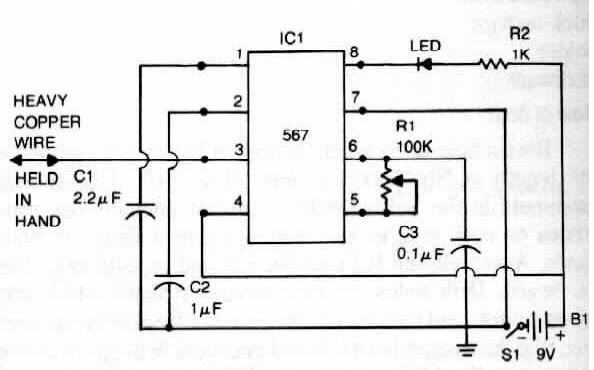

    How the Electronic Dowsing Rod works
    The electronic dowsing rod is basically a tone detector capable
    of detecting "tones" in the frequency range from 0-.01 Hz to 500
    KHz. The 567 chip contains a phase-locked loop. When the
    input frequency matches the center frequency of the chip, pin 8
    goes low and allows the LED to glow.
    The input frequency is the signal picked up by the dowser’s
    body, fed to the 567 through pin 3. The potentiometer R1, sets
    the frequency of the chip. This frequency can be determined by
    the formula:
    F=1.1/RC
    The 567 can be adjusted to detect any input between the ELF

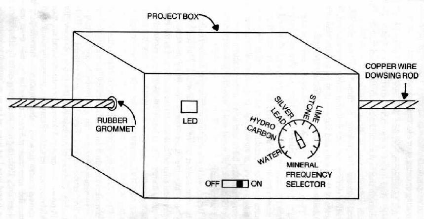

    Construction
    Bore a hole in each side of the project box to accommodate the
    length of No. 6 copper wire. Use rubber grommets in the holes.
    Make sure that enough wire protrudes on each side so that you
    can grip it firmly in both hands. Assemble the IC, resistor R2,
    and capacitors on the PC board. Drill holes for the potentiometer
    shaft, LED, and on-off switch, and then mount them on the front
    of the project box. Slip the assembled PC board into slots in the
    project box and wire in the LED and the pot. Push copper
    dowsing rod (No. 6 copper wire) through the holes provided and
    solder a lead from the copper rod to Pin No. 3 of the 567 IC.
    Mount the battery holder, double check you’re wiring and insert
    the battery. You are now ready to dowse.

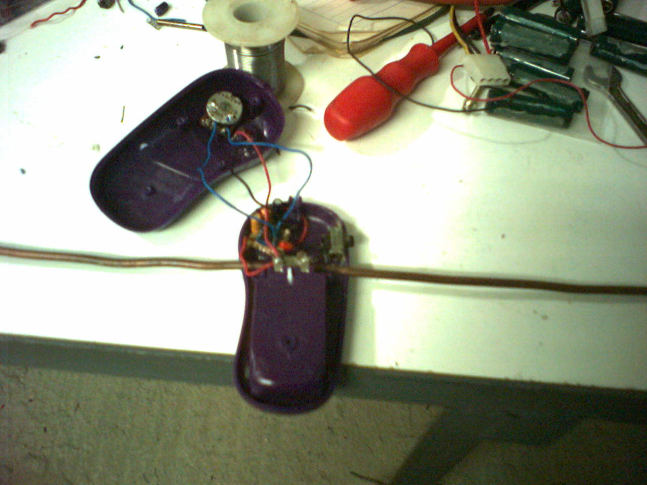

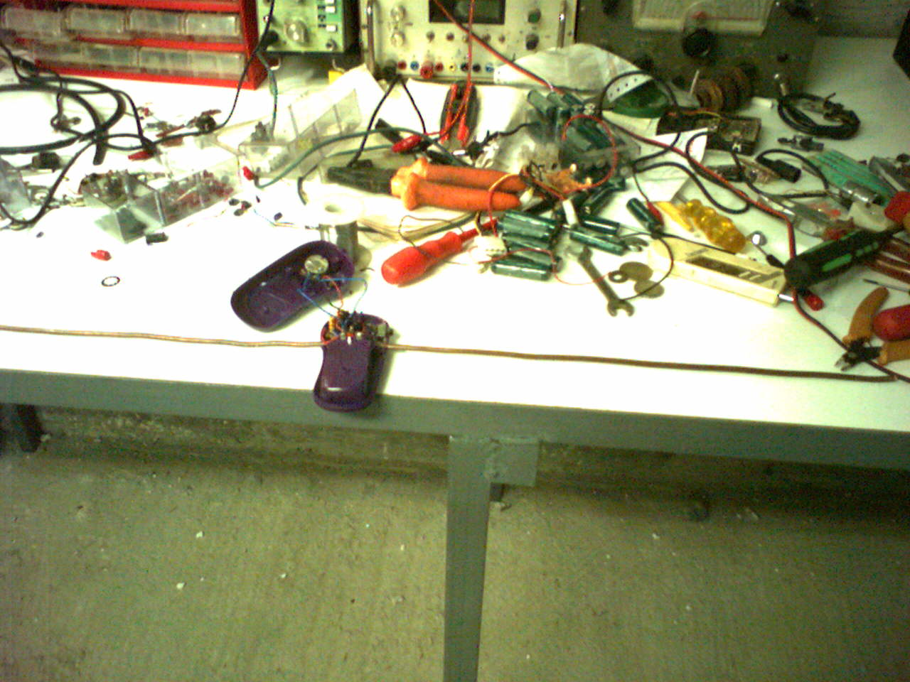

    Hi lostfox
    didi you use this rod before?
    can you sent it's picture
    how to handle it?
    it does not look like two rod dowsing

        I have used the 567 in Many projects and I really doubt in this circuit that your body could achieve the the required input voltage to properly trigger it at any real frequency.
        Also consider your body is constantly being Bombarded by many RF frequencies as well as 50 and 60 Hz. These are very high powered signal, compared to what any metal may Emit.
        Maybe the IC would get a bit higher voltage if that ground symbol on the schematic was actually a wire attached to a GOOD, "true earth ground".
        Also based on the fact that your using a copper rod and if it really did work, Why wouldn't it just always show as copper?
        Sounds really fishy.
        Just my 2 cents worth..........Gary

              according to schematic
              what is the total batary?
              9+9=18volt , because there are two cells in schemetic
                Just because he shows a Symbol for two cells does Not mean there are Two 9 volt Batteries. It only states one battery. But either way it wouldn't change the operation of the circuit.

                          Hi. I constructed it and maybe today or tomorrow i will try to test it.At the garden of my house the led indicates when the potensiometer is full left for water detecting. At every else position the led dont lights. I will go at the Farm to test it and after it as Ivconic says the 5Kgr hammer is ready for its Work
                            anybody please make traduction in spanish for my of this article of geo and the total page on this important report of answers
                            thanks detectoman
