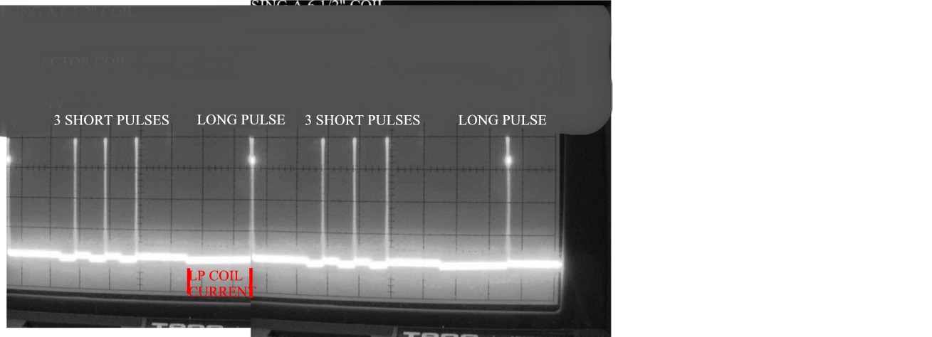

                          Hi Paul,
                          I have attached a pic of the signal out of the SD 2100. This pic was taken by using an external coil of wire located about 6" from the ML coil. The external coil had a dummy load across it so it would display properly on the scope.
                          The display shows ML's different pulse lengths. The short dip in voltage across the bottom is the actual pulse on signal.
                          Hope this helps.

                              Great scope pic. I'll comment on it in the other thread:
