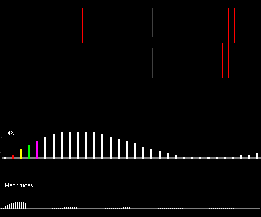

    Both Eric and Dave's base frequencies are really low. Not sure what harmonics they have since that could vary between designs. I believe they both said they checked emissions and it seems fine.
    My design on the other hand is the complete opposite as its pulse width will be adjustable as low as 500 nanosec and the base frequency will be adjustable to as low as 1.5 usec. I use a single turn 3' hollow Al tube, which has very low inductance, which means di/dt is extremely high. The signal is very square, which all equates to a lot of noise. See attacked image for computer spectrum generation. Top of image is signal. Middle of image is a blow up of spectrum, 4X. Bottom of image is full spectrum. In the 4X the red line = 100 KHz, yellow = 200 KHz, green = 300 KHz, purple = 400 KHz. As you can see, 100 KHz is low even though it's the base frequency. Peak is at ~ 900 KHz.

                  If you screw up your TV picture, then something else is wrong. I had a PI design that failed an emissions test, because I had a long track on the pcb that carried a clock pulse with a fast edge. The track was acting as an antenna. In PI designs, you want to use the slowest logic that you can get away with, to minimise harmonics from that area.
                  The 3kHz whistle from the transmitter of my GS5, with 11in coil, is barely audible at 500kHz on an AM radio, 4m away. On 200kHz, long wave, I can just pick it up at 8m, but as soon as I tune into a station, it is inaudible. This is with the radio aligned for maximum pickup.

                                on your pulses, I've seen that done for measuring the hysterises on iron and such, but the first pulse will induce eddy currents one way, the second pulse will induce them the other way, somewhat cancelling the first pulse and then you sample what is left? (not much? in non ferrous) little more in iron?
                                I don't get it.
