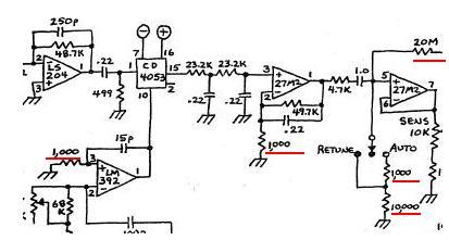

    Anybody have information on IC 27M2 (op-amp)??? I have been seen that in many schematics, but
    i can not find it in any catalogue, due to know it's characteristics or any possible
    replacement...
    Also i want to make Tesoro Diablo Gold Demon, but few things are not clear to me. I am
    wandering about those couple resistors in schematic, designated as 1,000 ???
    Is it 1 000 ohms and should be designated as 1K or it is 1 ohm, and some joker wrote it
    with comma and 3 zeroes with no reason. Or it just has to be exact 1 k or ohm without any
    tolerance !?? According to my opinion it should be at least 1K at that place,although it
    will be very strange to couple that input to ground with so less resistance !?
    This schematic is so simple and easy to build so i would like to do it right.If someone
    would like to help me about my doubts, i would be very gratefull. Many thanks in advance!
    Also,anybody have any information on suitable coil for that detector? Tesoro Diablo Gold
    Demon?? Any hints?
    Hi
    Yes, I think are corrects the values 1,000 and 10,000 as 1 K and 10 K, in consideration the positions in the circuit. Any Tesoro coil working at 6.5 kHz is OK. More rare is the 20 M...? Or must be 20 k? Anyone has builded it?
      1000 ohms looks like a prefectly normal value for this application.

        I found out that 27m2 is TLC272 or one of it's clone....LS204 is also
        high.sens. op-amp...The rest of schematic is "beans".....

          I finished Tesoro Diablo Gold Demon today.It failed to work.Checked again and again all.
          Nothing! I made no mistake in pcb,components and etc. I put sockets on ic's. Overall
          power consumption is 70-80mA.When removing LM392, it lower to 15mA.LM 392 is o.k.
          I have a few of them,switched them around and always the same story!? 2907 output refuse
          to oscillate. I put 330nF parallel to TX coil.When remove that condenser, 2907 start to
          oscillate at 80kHz with drifts,but when adjusting with trimm. 2.5 K i can lower it even
          to 8-9kHz also with drifts from time to time.
          I checked various condensers with it and always the same story,it stop at once to oscillate
          with some condenser on it.
          When switched ON,i can hear pleasant tone for a while(5-6 seconds) than stop, and
          no more tone. Adjustments with pots. and trimms. has no affect on it, only another
          trimm. 2.5K increases tone pitch at start. 7660 is working nice, 7555 also,4024 also...
          Checked many ways and i am 100% sure that those i.c.'s are good and working.
          Positive rail is 4.9V, negative sometimes 4.7, sometimes down to 3.96V, depends on
          diff. i.C.'s in sockets. Instead of lS204(can't obtain it) i checked a various op-amps like
          TL062,TLC272,LM358,LM393 etc. 27M2 also unknown so i put TLC272 instead of it, but also
          checked other op-amps on it's place. Nothing! No damages so far,everything is calm,
          nothing burns so far.....!?? I put 7805 (2A) and sometimes it is warm, but not critical.
          I am 100% sure that used good i.c.'s. Also tried several coils with it.NOthing!
