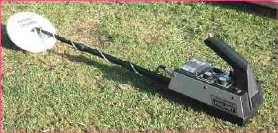

        Hi Dave,
        In case others are wondering what a C Scope Promet 3 looks like, here it is:
        It's an early C Scope IB detector.
        In what way is the detector intermittent? If you give a tap in different places - the search head, control box, cables, plug assembly, etc., does this cause the problem? If so, then there's probably a bad connection in that particular area. If the problem is in the control box, then yes it might be a dry solder joint. Bit difficult to tell without seeing it firsthand. Try jiggling the different parts of the detector to try and isolate the problem.

            forgot to add these
              Ahh! - different Promet model.
