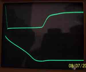

I am trying to build a detector for small nuggets. I have wound a coil with a resonant frequency of about 750 khz. (310 uH, 11" diameter, 2 Ohm)
On the output of the preamp I get all sorts of noise, but the strongest is at about 750 khz. I take this to be "white noise" that shows at the resonant frequency because of the enhancement caused by the resonance. Is there a way to get rid of it?
Another problem at the input of the pramp (5534) is a "kink" at the point where the limiting diode stops conducting. No matter more or less damping resistor, the kink stays.
At present I can sample at 5 us, If I could solve the above problems, I could gain one more us at least.
Any good advice is welcome.
