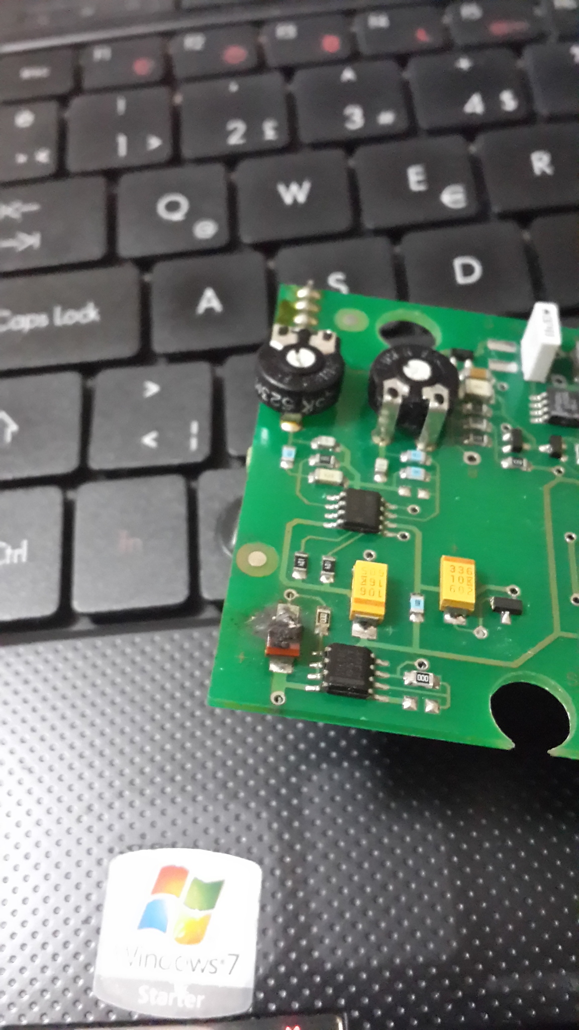

                    http://<a href="http://hizliresim.co...&#91;/img]</a>hi guys
                    thats garret gtax550 on coil connector board.. whats that part value?
                    http://i.hizliresim.com/vo6PJD.jpg
                      It looks to be a blown surface mount tantalum capacitor. Note the + sign near one end like the other capacitor nearby. Value? Maybe be the top of the cap was still inside and you can get the value off of it. Otherwise, perhaps another member of the forum can open up their GTAx550 and give you the value. I was unable to find any pics of it's PCB online.
