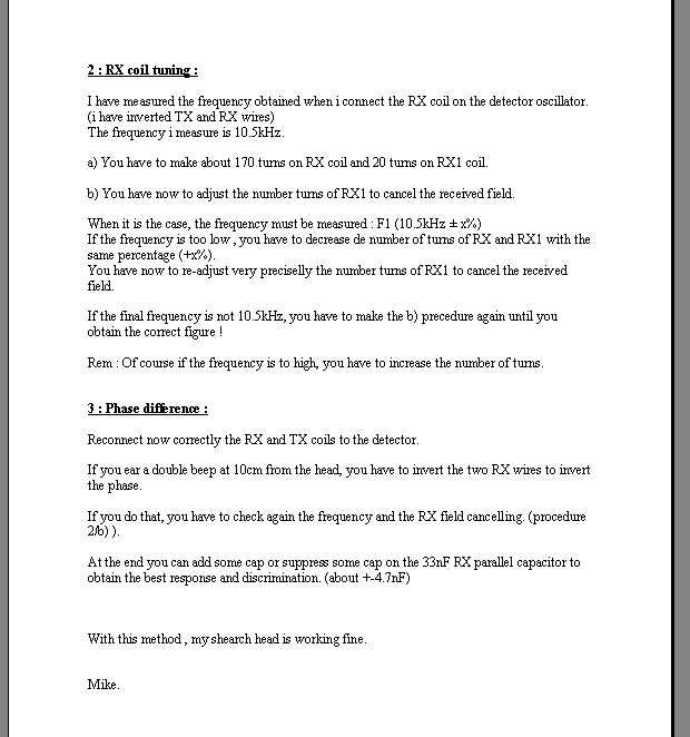

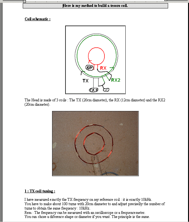

          maybe help.
              Hi KT315
              excellent explanation of the method.
              Much obliged for your time and effort.
