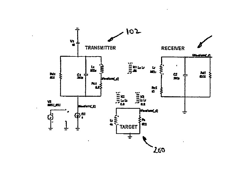

                Hi Frank,
                I am sorry if I came across wrong also. My intent was to let people know when George Payne speaks, he knows what he is talking about. Many beginners are not aware of his accomplishments or abilities and as such have a tendency to question his facts.
                Now, I have to admire you Frank because you expressed yourself very well in english. I wouldn't have known it was not your primary language. I am still struggling with one and that is english. So, you are way ahead of me in that area.
                Personally, I wish George Payne would finish his book. This would help greatly since he planned on discussing detectors from the basics to the most complex features.
                Now, as for your request, it is very difficult to explain how a detector works without writing a book, especially a VLF.
                Basically what happens is a coil is built such that the receive winding is nulled or positioned such that there is no or almost no signal in it. This may require an additional winding to cancel any transmit signal.
                Now, one can connect a scope to the receive winding and not see anything or almost nothing at all. Now, once some object enters the field of the coil and that object has some magnetic or conductive properties, that object will cause the receive signal to change and increase. Also, there will be a corresponding change in the phase of the signal.
                In other words, the receive signal will get larger and will shift with respect to the transmit signal. By analyzing the shift, we can determine much about the object.
                Patents help because many of them do explain the principles of what is happening. However, some are quite confusing and a few are inaccurate in some respects. This is why it is a good idea to read several.
                Now, in my previous postings, I mentioned X and R. I also mentioned that any target (any object that is detected) can be simulated by an inductor and a resistor. Generally, they are shown in parallel. Now, when we analyze an inductor and resistor, we know there will be some phase shift since a pure inductor will have a phase shift of 90 degrees, while a pure resistor will have no phase shift. Now, if we let X equal the inductance characteristics, and let R equal the resistance characteristics, then the the ratio of X/R is the tangent of the particular phase. It is this tangent that provides the signal used for target ID (TID).
                So, if you have taken electronics and learned about the phase angles and what happens when a resistor and an inductor connected to a circuit, then you have a better idea of just what is happening.
                In the case of the objects detected, the better the conductivity, the higher the R value and lower the X value.
                Now, the coil and associated circiutry can be thought of as a transformer and the target as another secondary windings. I have a poor pic I copied from a patent that sort of shows what I mean and attached that pic.
                Because the target has both inductance and resistance, it will cause a signal shift accordingly. Now, once the signal is amplified, then it can be analyzed with respect to the transmit signal to see if there are any phase shifts as well as amplitude changes.
                The rest of the circuitry basically does this type of analysis. Just how it does it, is quite complex and not easy to explain. If you go back and read some of the earlier patents, you will see it takes several pages of information just to explain how the sample is taken to create the all metal mode on a VLF.
                Basically, what is done is to take a sample that is in sync with the transmit pulse. Now, by adjusting the phase shift between the two as to when the sample is taken, we can get a different type of information. If the phase shift is taken properly, we can obtain a signal that ignores the ground signal and only the target response is heard. This signal is commonly called the R signal or all metal signal. Actually, not all of the ground is ever eliminated, but most is.
                Now, if we take a second sample 90 degrees or so with respect to the main sample, this signal is sometimes called the X signal. Now, by combining the R signal and the X signal properly by taking the ratio of the two, we can now analyze the target itself. Unfortunately, when we take this second sample, there will be a lot of ground signal to deal with and that ground signal will inhibit any logical analysis unless something else is done.
                One thing to note is we do not have to be exact on this second sample. In other words, it doesn't have to be exactly 90 degrees, but does have to differ sufficiently from the main sample. On some detectors, this second sample is or can be up to 135 degrees or so different.
                So, what is done is to filter out the ground signal, or at least try to. The reason this works has to do with the coil design and the signals themselves. Generally speaking the ground signal is a very slow changing signal that varies because we do not keep the coil level. However, this is only true when passing the coil over flat ground such as commonly found in parks or yards where people look for coins.
                Anyway, on a motion detector, there are filter circuits built in that are there to remove this ground signal. The number and type of filters will determine just how well that is done.
                Because a coin or other metal object is small and very different than the surrounding material, the coin (target) will produce a sharp pulse type signal. This sharp pulse type signal has harmonics that can be filtered out. So, by using a bandpass filter that rejects slow signals (ground signals) and amplifies faster signals (target signals), the target signal can be separated from any ground response.
                Now, this filtered signal is then compared to the all metal signal which will go through identical filters to assure the timing is the same.
                The final filtered signals are then analyzed to determine the target.
                Unfortunately, that is about as good as I can explain it without writing a book to cover each aspect in a much finer detail.
                Hopefully, this simple explanation will make it easier to understand some of the patents.
