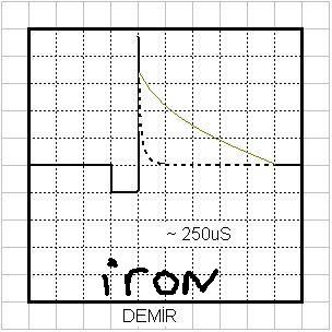

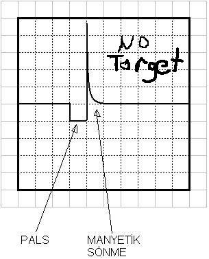

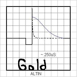

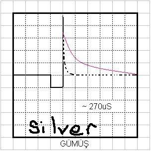

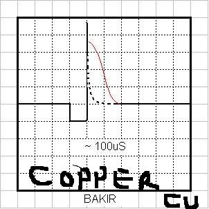

PI test results
    ones who insist discrimination for PI
    these results from DELTA PULSE
    look here and say
    how can you differ gold and iron
    since delay times are same, and do not know type ,size and dept of target.
    with different size targets and different depts I am sure we can achive same graphics.
    waiting for intelegent answers
      Decay curves

        I took them from another forum page.I will ask for these.
        I know you have scope.
        do you have same delay times for gold and iron.
        for coin hunters discrimination would be posibble.since most coins are at same sizes.
        but for deep tracers sorry ,we have to wait for something else.
