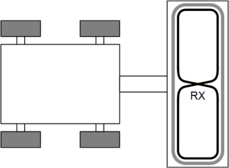

                Since search speed is a goal, I would suggest a Figure-8 coil as wide as you can make it. It several advantages:
                • Good RX sensitivity at the extreme widths
                • Good noise cancellation (it has a positive lobe and a negative lobe)
                • Easy to build, easy to null
                • Not dimensionally critical
                The downside is that there is a target null at the dead center of the coil, and targets in the positive lobe give a positive response while targets in the negative lobe give a negative response. This can be fixed by taking the absolute value.

                  when you say that the response is reversed at each lobe, you mean the amplitude of the received signal right? what about the phase shift?
                  I mean can still use a GEB channel with it?
                    Yes, GEB will still work but to get it to ground balance you will need to tilt the coil so one lobe is closer to the ground. First order, this coil has a natural cancellation of ground even without GEB, but setting the GEB to some nominal position will make it even better.
