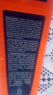

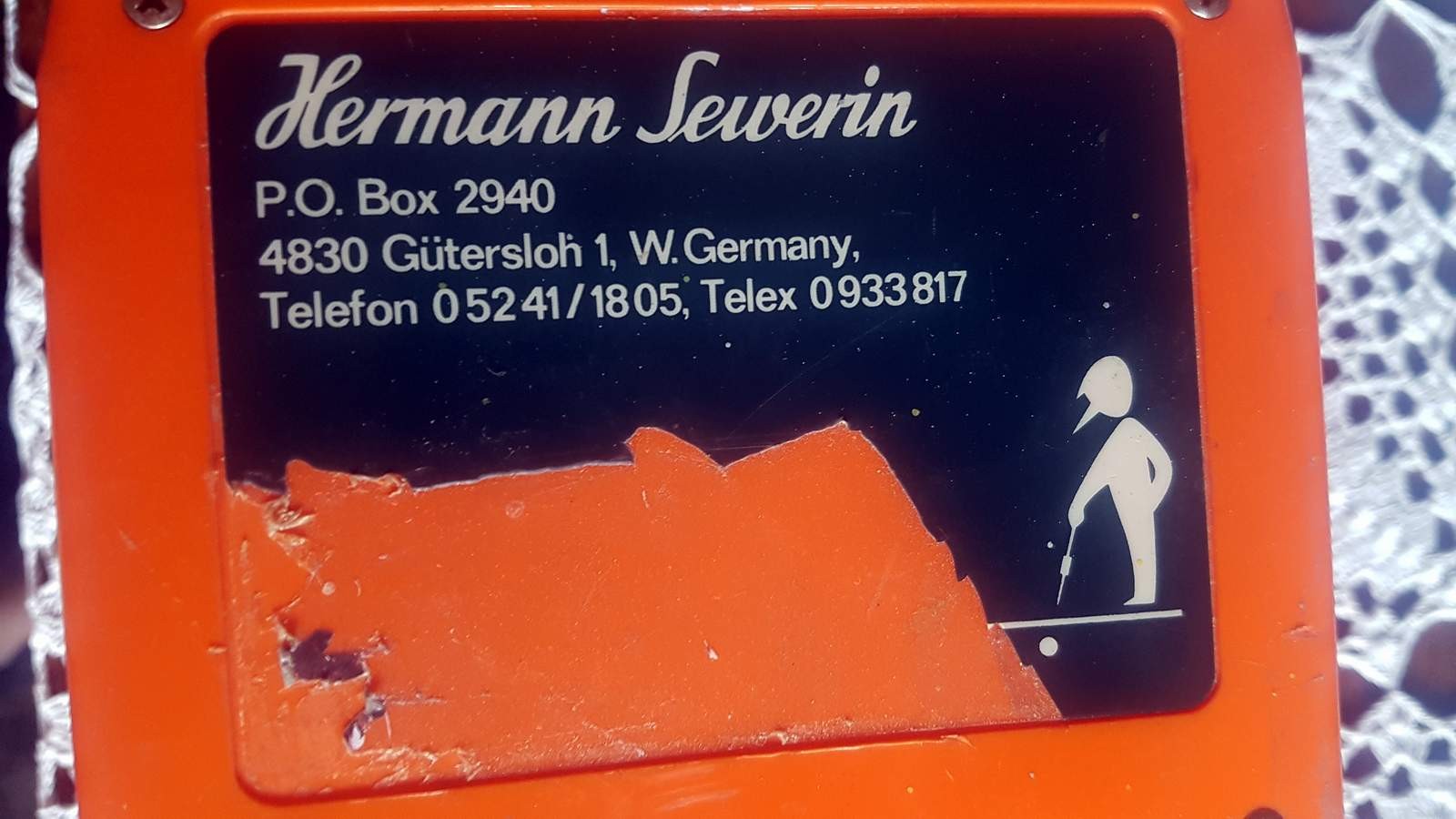

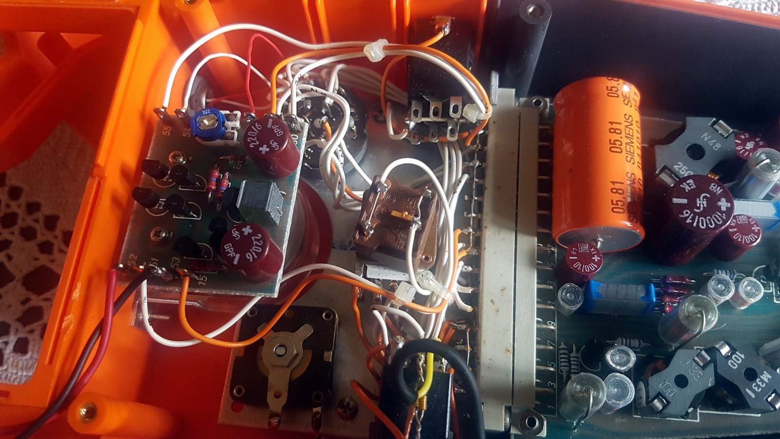

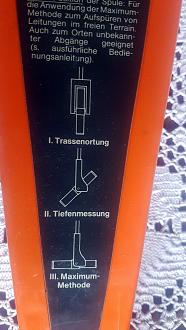

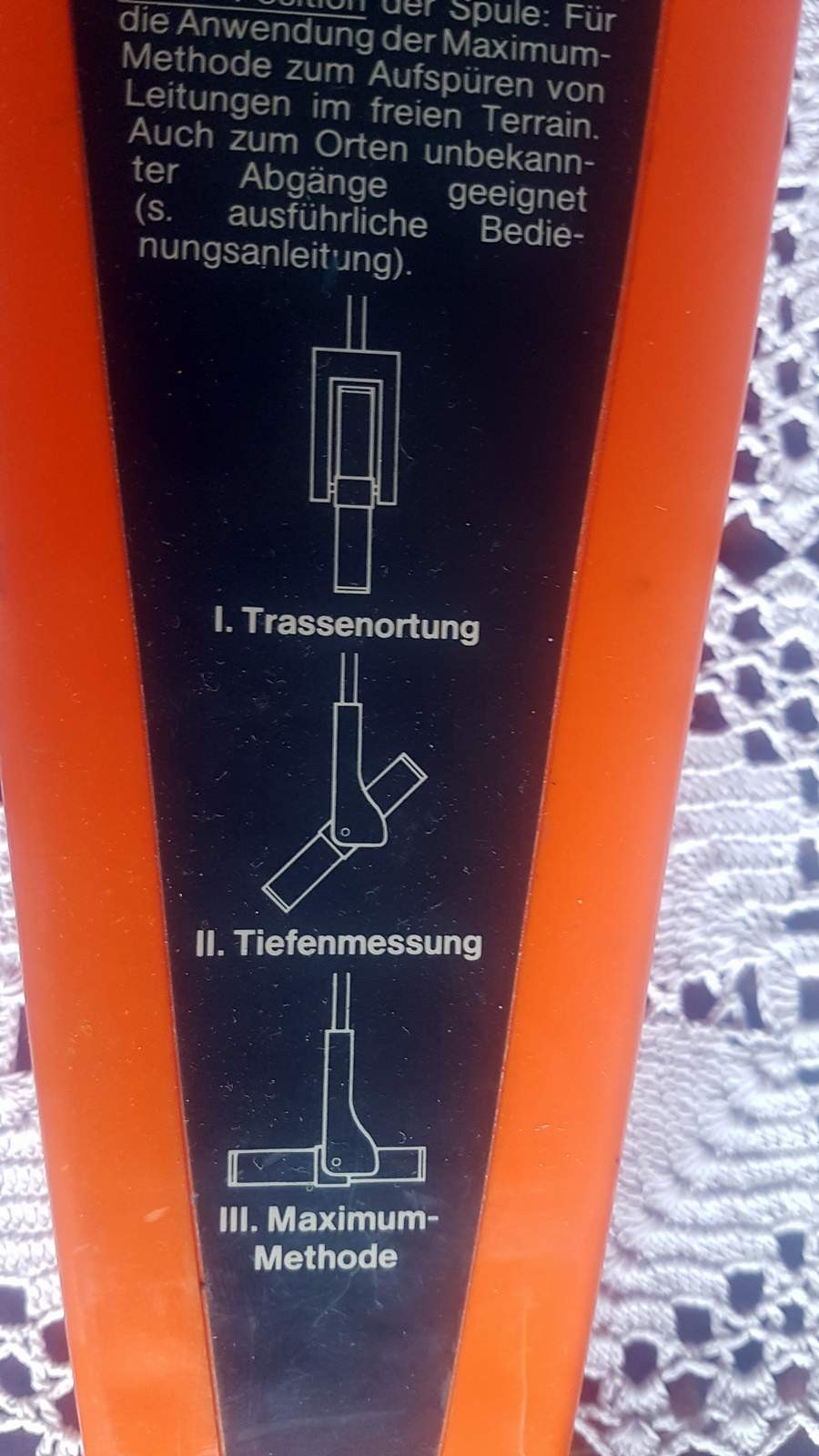

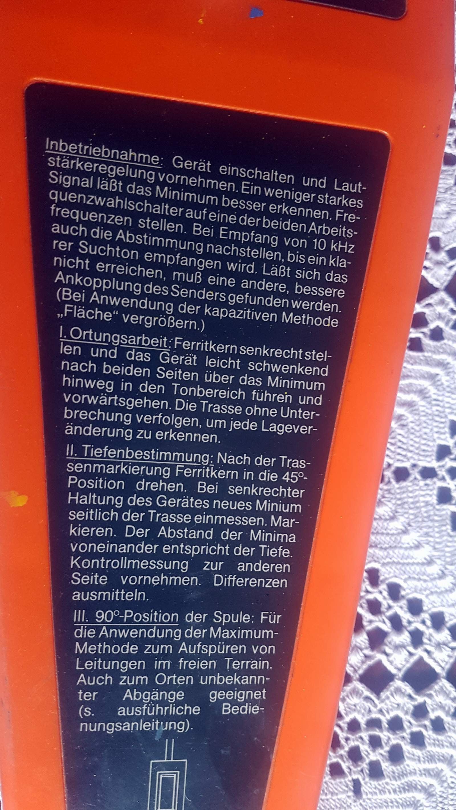

      Is it cable locator?
      Is it ulitlity locator?
      A man brought it the other day.
      Kinda "working" but I am not sure is it faulty, broken...
      There is 170mH coil on ferrite rod as the "sensing" component.
      I was thinking to dismantle it and to take that coil for experimenting.
      But, if this is the device of some value; I would like to know and not to take it apart just like that.
      Didn't have time to pay more on analyzing it, these days too many responsibilities.
      If anyone know more details on this; please share here, help me to preciselly classify this type of the device.
        Very quick Google search result:
        Hermann Sewerin GmbH Technology leader for gas and water leak detection equipment The Sewerin group of companies is an internationally successful, family owned group with its headquarters in Gütersloh, Germany. The core business is the development, production and global distribution of electronic measuring equipment for the gas and water supply and distribution industry. A global distribution network covering more than 80 countries makes Sewerin one of the leading companies in its field of expertise.
        So it is probably a pipe detector.
            The second part of the device will be a generator pinned to the pipe somewhere at the beginning, this device is a portable sensor / locator.
              Judging by the large ferrite transformers, I think this device is likely to be a generator as well as receiver. It could operate in receive-only mode, if used with a seperate transmitter unit. It's very clean inside, for a 1981 vintage device. The usual suspects are of course the electrolytic capacitors.
                Yes, pipe & cable tracer. Those big transformers are more likely the RX filters. There would have been a separate TX unit that either direct-connects or inductively couples to the pipe/cable. The swivel inductor is new to me. If you put it horizontal you get a peak reading directly over the line, if it's vertical you get a sharp null directly over the line, and placing it 45° lets you triangulate the depth of the line. Modern line tracers usually have 2 horizontal and 1 vertical sense inductors, plus a transverse "azimuth" coil for sensing rotation. The 2 horizontal coils are spaced vertically and can give you an on-the-fly depth reading.
                  It must be a very old device already. Because you can see it from the address sticker. The zip code is pre-1990's and it says "W. Germany" (West Germany). From the componets used on the PCB it looks like a typical mid 1980's device.
