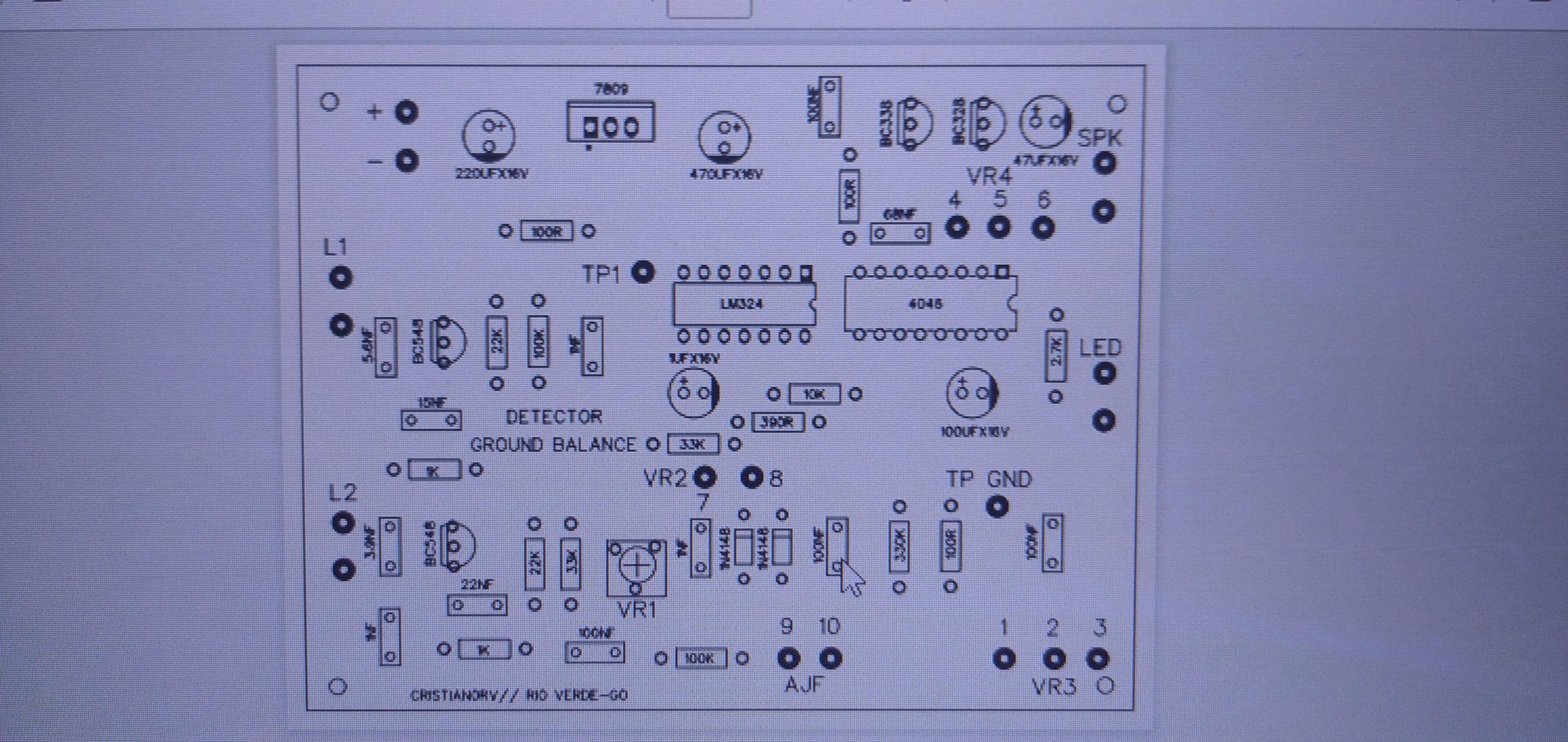

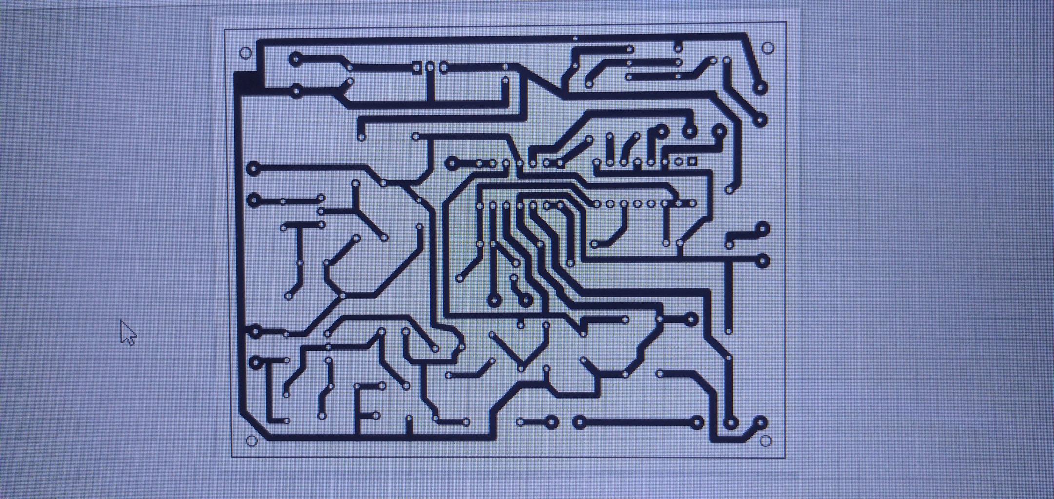

                              I DON'T KNOW IF IT ACCORDS WITH THE ORIGINAL SCHEMATIC. BUT IF SOMEONE WANTS TO CORRECT IT. https://drive.google.com/file/d/1l0N...usp=drive_link https://drive.google.com/file/d/1_d0...usp=drive_link https://drive.google.com/file/d/1NvX...usp=drive_link
