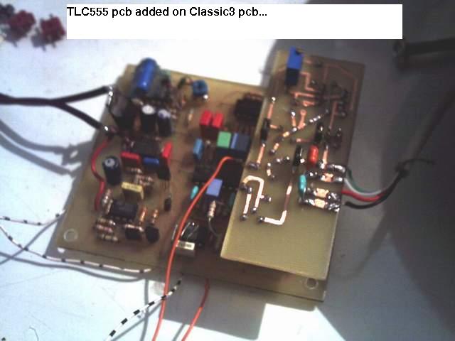

IT WORKS
First I have to say thanx to all helping here..
CLIII is working now both in all metal and disc. modes
Fault was in bad LM324 - I replaced it with new one and it works.
I have also tried MAX448, MAX494, MCP604 all working no great differences.
Ivconic: Jackdetect already corrected 220K-47nf problem on his PCB, that 22k resistor is more tricky to spot.. also all jumpers are OK on protel file.
I made just some minor modifications like RFguard on upper side.
What I have learned from this?
*check ic's twice..
*Replacements for U3 (LF444) are:
LM324
LS404
TL084
MAX448
MAX494
MCP604
and probably lots of others
Now I have to make proper coil - probably one DD like Geo made and later on concentic.

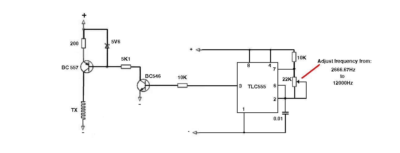

. Now try to modify RP2 as at my schematic (one side at +E and the other at -E, not at gnd). You will get more sensitive
???? It is a good way to regulate the power of the detector transnitter. I have one piece so if i will have free time to give it a try
