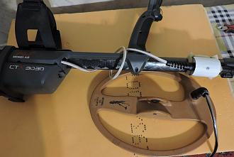

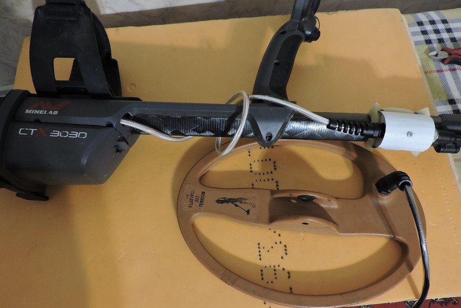

                          I'm making a board takeaway from a CTX3030 coil. In this case CTX3030 works with any Explorer coils. No loss of sensitivity.
                            Originally posted by FOMA View Post
                            Amazing work!

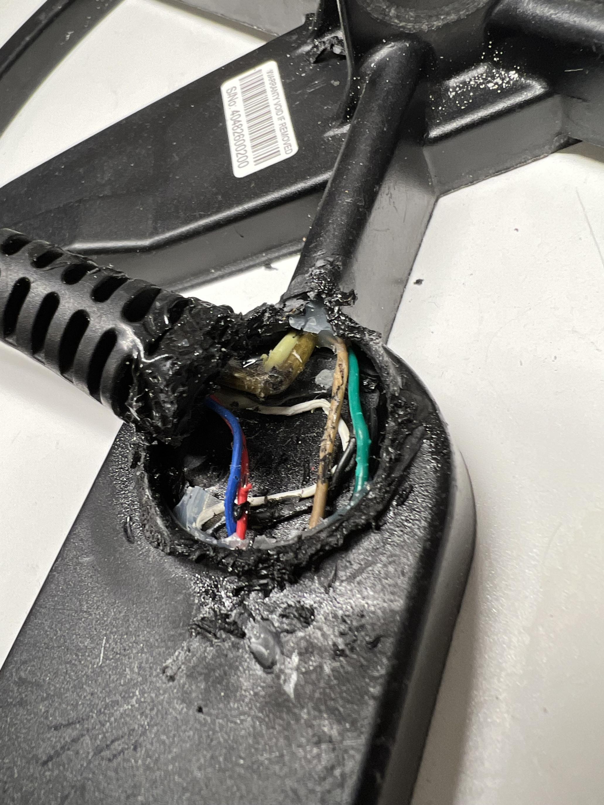

                              One coil has no TX output. Tri-field meter is great to diagnose this. The other is “no coil detected”, which is the attached:Click image for larger version  Name:	70520882631__972C55AF-A128-4BCC-878A-31E8F383031B.jpg Views:	0 Size:	670.4 KB ID:	412245
                              All colored wires buzz ok to the cable connector.
                              Brown and green buzz together too.
