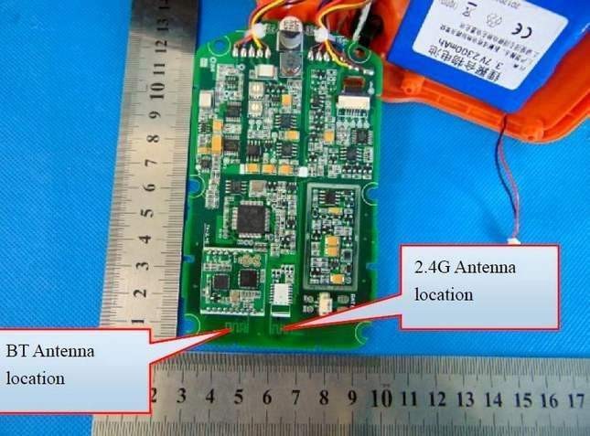

          Thanks! The front end looks like it's all analog.

            I'm assuming that the LT6233 you mentioned is the S6 package(6-lead plastic SOT-23). input offset voltage is only 350uV Max.
            Is the Rx coil in series with the cap. Looks that way on the pcb.
              Yes, that's right. The opamp is in that case.
              As for the rest; I closed the box and wouldn't want to open it again.
              It would be a risk of damaging the threads of the 6 small screws.

                The front end RX circuitry and the TX circuitry and phase shifters(I think I see an LM393) looks to be all analog.

                      ivconic If you have more pictures, could you please share more detailed PCB pictures?
                        That's all I have.
                          That's all I have.
                          if one day you make a decision to open the box again take more photos please
