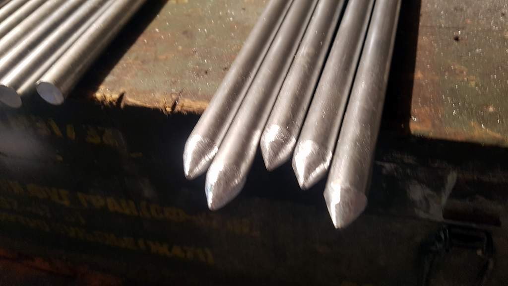

    Production of soil probes from duralumin. I spent last 50e on 6m bar and then cut 20 x 29.5cm pcs from it...

      Manual processing of the tips with a fixed grinder, a lot of the finest aluminum dust in the air and on the workbench... that's how chemtrails are produced!
      All that remains is for me to direct a strong fan at the neighbor and sprinkle him with handmade chemtrails!

        In your case, it is inexpensive and reliable to make rods from stainless electrodes for welding
        • #49
          Those rods look pretty large diameter. I would expect thinner rods to work just as well, but they will push into the ground much easier.
          Spring steel, 3mm to 4mm ( 1/8th inch ) would be OK, I have a bottle-digging probe that is made from 3.7mm spring steel. Perhaps if the steel was given a good copper plating it would improve electrical performance, and protect the steel from rusting, too.

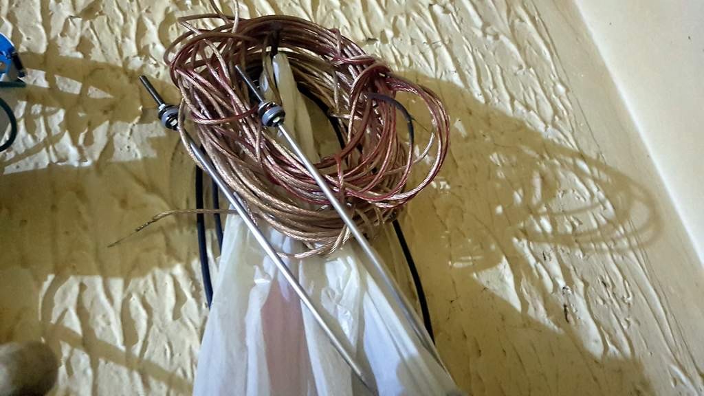

            Artyom and Skippy... see these two probes?
            They are 6mm diameter, stainless steel, sharpened at the tip like a razor.
            I have 4 such, those left from the resistivity meter.
            The other day I went to the forest where there is shade and increased humidity in the ground.
            Forest land, typical, common, has a lot of small stones here and there. Plant roots etc.
            I was not able to push the probe into the ground even 10 cm with my hand.
            So I tried to step on it.
            It started bending??
            That's why I decided on these, duralumin, 15mm diameter, 29.5cm long. Strong, unbending.
            They will have to be "hammered" into the soil, either with a hammer or a larger stone.
            Somewhere it will be easier and somewhere more difficult.
            Sites of interest, which I have been visiting for years, where there are silver denarius and
            gold tremisis and solidus... those sites are mostly with a lot of stones mixed with earth.
            I know in advance that it will be difficult. That's why these duralumin probes are the right solution.
            After all... the original ones are "thick" and strong, but made of iron. Like giant nails.
            So it has already been shown in practice that thin "steel" ones are not good, at least for these soils that I have here.
            In order for all of this to make sense, to have an effect, to achieve some real results;
            the probes must be "rammed" into the ground at least 20 cm.
            As I said, these are 29.5 cm, I plan to ram them up to 25 cm into the ground.
            If the composition of the soil in that place allows.
