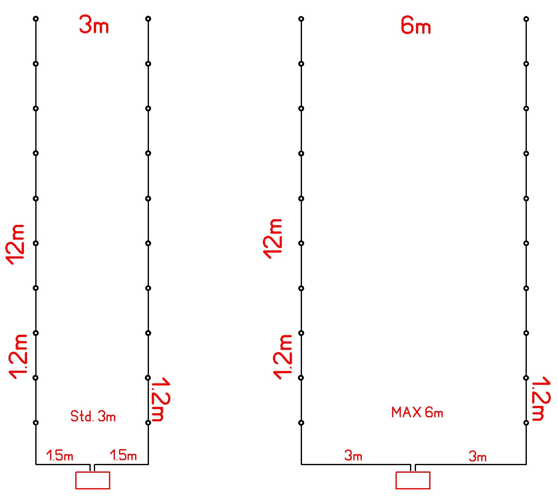

        A few comments:
        Ten probes spaced 1.2m apart means the total length is 9 x 1.2 = 10.8m , not 12m.
        I think if the probe lines were staggered by 0.6m ( half of the probe seperation ), the device may have a more even effect of the ground and targets.
        I would connect the electronics box to the 'blue' probes with a short ( 30cm ) wire, and run a 3m wire to the end of the 'yellow' probes. If a spacing greater than 3m is used, add a single 3m extension cable into the 'blue' probe line.
        What do you think the best cable to use would be ? I was thinking flexible test-lead wire, like that on a DMM. High current rating is not needed, so the thinner stuff would be fine.
        The electronics box could be built with two 'yellow' sockets and two 'blue' sockets. And the probe set is split into two sections, such as [ 2 x 5 plus 2 x 5] or [2 x 6 plus 2 x 4 ] , which would give you the option of running smaller installations if needed.
        Do you think a 3-row set-up would work ? I think three rows of 5 probes would be electrically like two rows of 10 probes. The middle row connects to the 'yellow' output, the outer two rows connect to the 'blue' output. That would cover the same surface area, but needs only 15 probes, not 20.
        • #94
          Your math is bad.
          You don't want the device to be between the two probes or near the signal path, but slightly outside the "rectangle".
          You get a larger area to search. A longer cable is not a problem. That's why I left 10x1.2m = 12m.
          Otherwise, the length of the cable is not important, in my case I will use 2 cables of 15 meters each.
          I chose a cable with silicone insulation and very rich fat litz. It is a conductor made of ~30 twisted strands.
          I think that the original purpose of that cable is to connect strong sound systems with a power of 500W and more.
          That cable is otherwise very strong and about 5-6mm thick with insulation. Very elastic, suitable for frequent manipulations.
          That's why the cable has a very low resistance, I didn't measure it, but I know from before. 0.2-0.3 ohms for the 20 meter cable.
          So a few meters more or less; does not bother.
          The whole setup is quite tentative because it is the soil properties that will cause frequent changes in that configuration of probes with cables.

              ..I think if the probe lines were staggered by 0.6m ( half of the probe seperation ), the device may have a more even effect of the ground and targets...
              And I think that's true.
              But there is no need to change the length of the cable in that case.
              The probes remain on the cable according to my sketch from the previous post,
              you only gather the probes to a smaller distance and throw the "excess" cable between them outside the "rectangle".
              Because in this way with one and the same cable and "clips" for tests, which are soldered to the cable;
              you can reduce the maximum area (12x6m) to smaller areas if you wish.

                  "Ten probes spaced 1.2m apart means the total length is 9 x 1.2 = 10.8m , not 12m"
                  "Your math is bad"
                  So you think the effect of the end probes will extend 0.6m beyond the end of the rectangle, increasing the area covered back to (10.8 + 0.6 +0.6 )m by 3m? Seems reasonable.
                  • #99
                    "Your math is bad"
                    Generally yes.
                    But individual conditions in the soil will significantly affect the width of the signal spread from probe to probe.

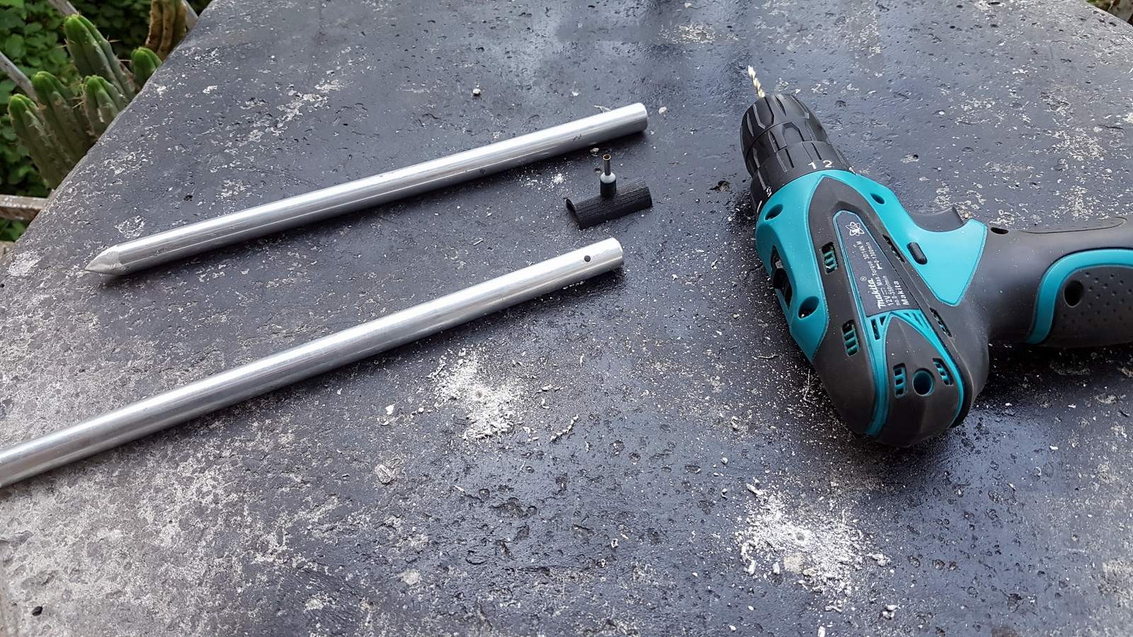

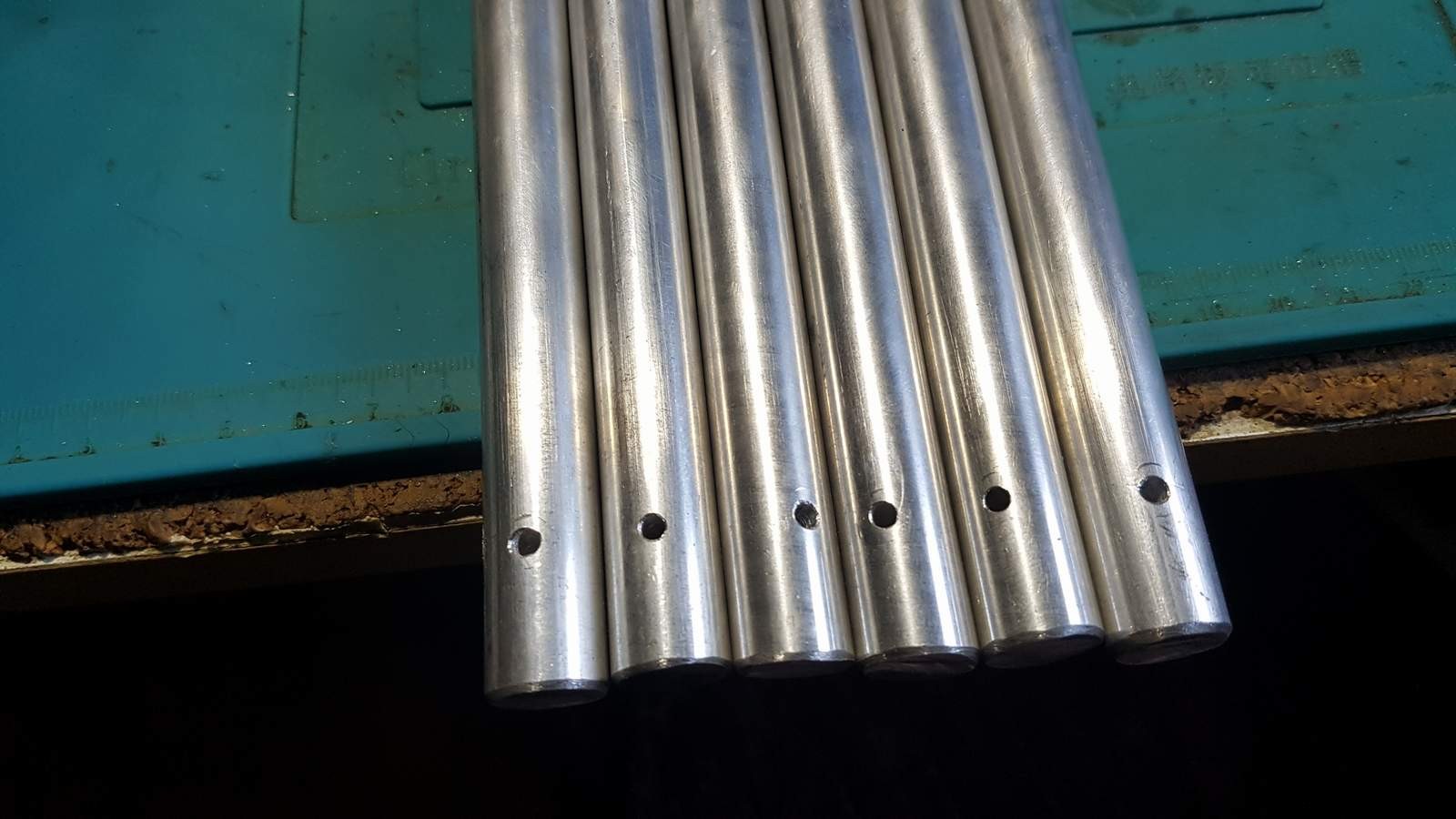

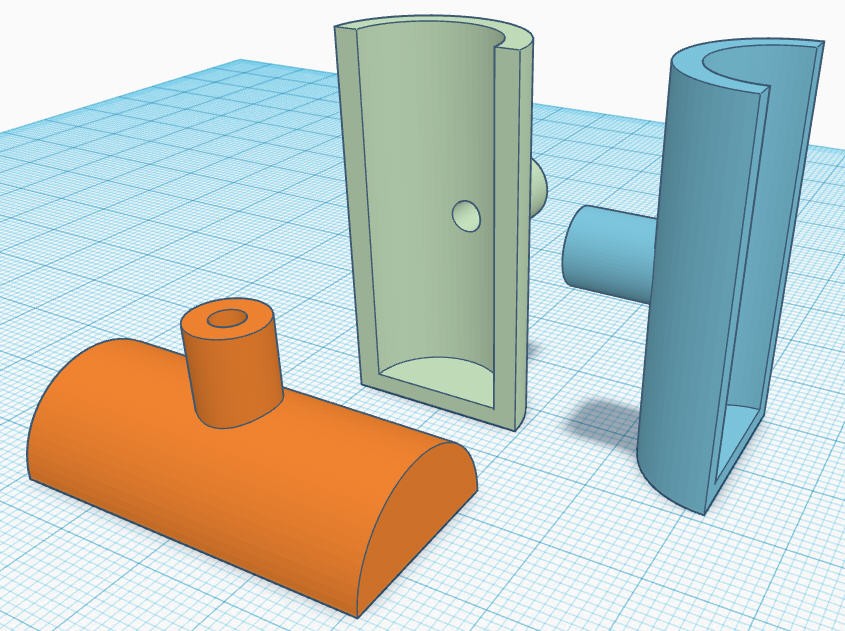

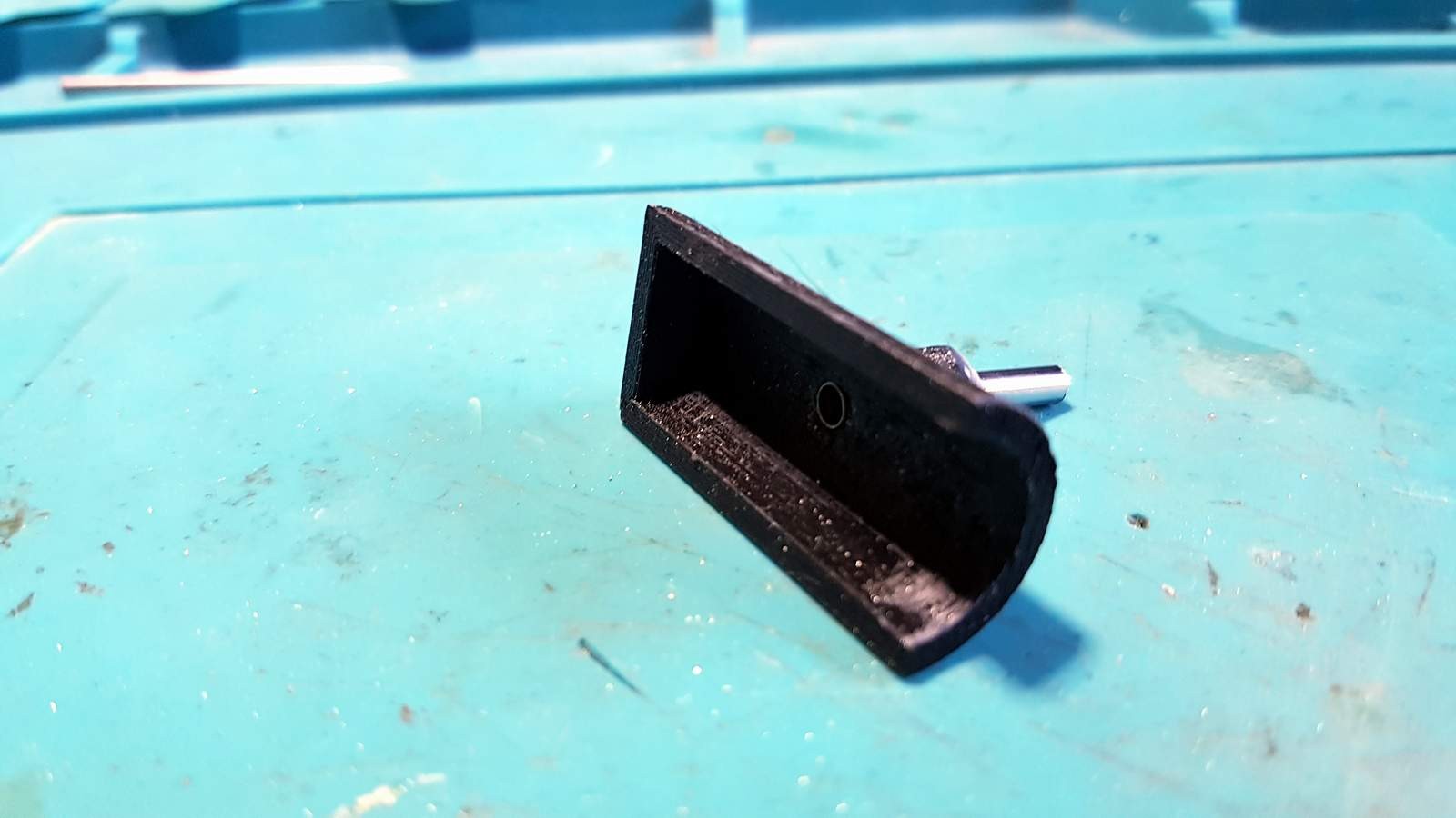

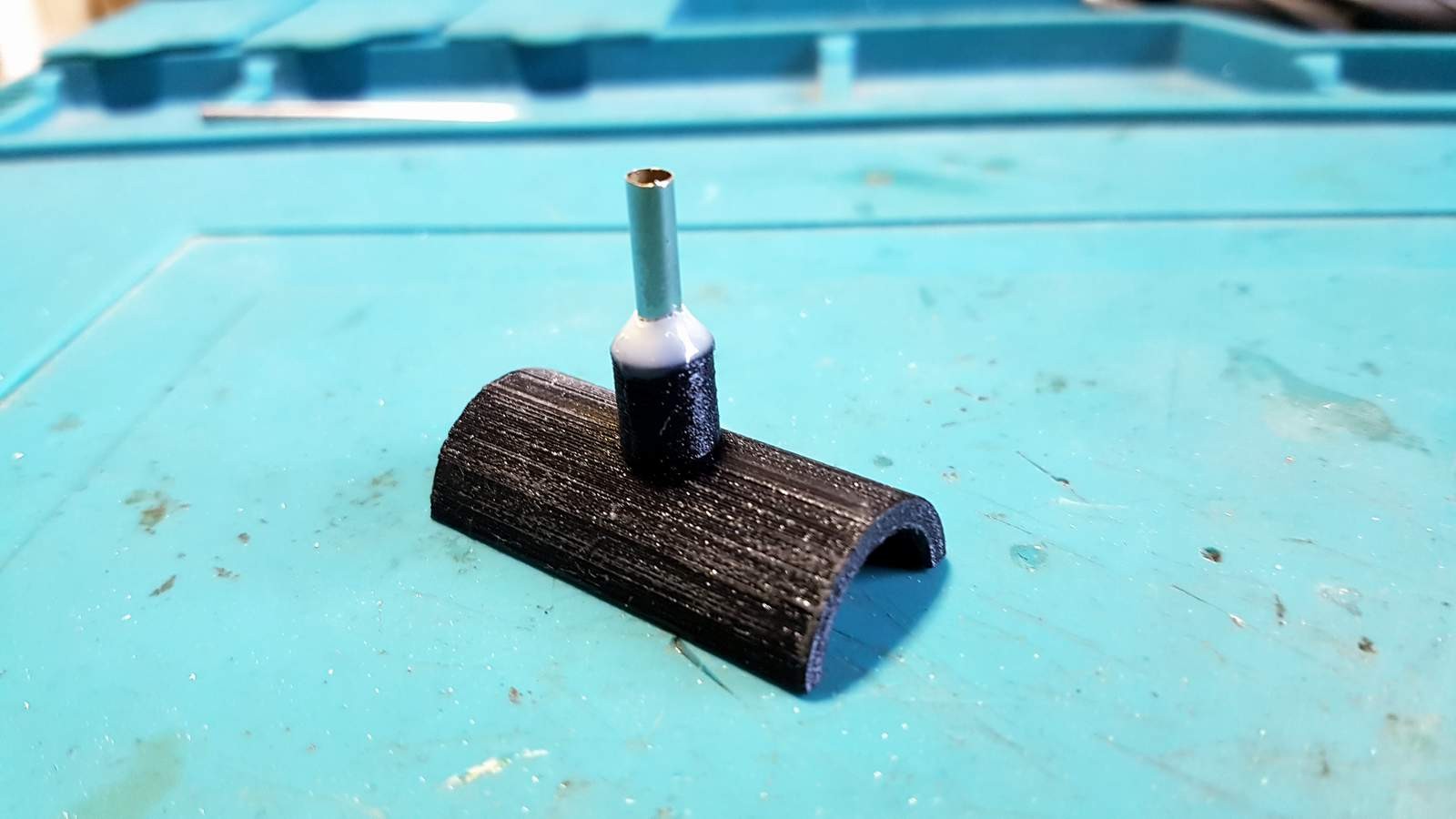

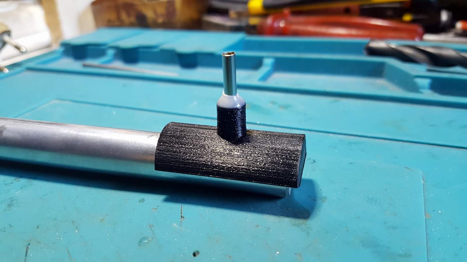

                    • How to accurately drill holes on such bars?
                      And that the holes are regular and always in the same place on the rod?
                      There are many ways in professional machining.
                      From the lathe as the most precise... all the way to the ordinary column/pole drill.
                      A lathe is an expensive toy to have in a modest electronics workshop.
                      Column drill... so... there are ads with prices as low as 60e.
                      Made in China.
                      I had the opportunity to see them at an acquaintance's house.
                      They are of no use. They have a "gap", they are not precise, they are wobbly, very badly done... although visually they look very good.
                      But who has tried to do some work; he realized how badly it was done.
                      I assume that there are also very high-quality column/pole drills, but the prices are probably very high.
                      If only a man could have everything he needs!
                      And how can I now drill 20 bars and have all the holes be regular and in the same place?
                      Very easy actually!
                      Click image for larger version  Name:	Sketch.jpg Views:	0 Size:	129.5 KB ID:	414065Click image for larger version  Name:	20230808_182123.jpg Views:	0 Size:	133.2 KB ID:	414066Click image for larger version  Name:	20230808_182128.jpg Views:	0 Size:	132.3 KB ID:	414067Click image for larger version  Name:	20230808_182133.jpg Views:	0 Size:	111.7 KB ID:	414068
                      Click image for larger version  Name:	20230808_182155.jpg Views:	0 Size:	158.4 KB ID:	414069Click image for larger version  Name:	20230808_182159.jpg Views:	0 Size:	135.6 KB ID:	414070Click image for larger version  Name:	20230808_182203.jpg Views:	0 Size:	149.8 KB ID:	414071Click image for larger version  Name:	20230808_182234.jpg Views:	0 Size:	527.5 KB ID:	414072
                      Click image for larger version  Name:	20230808_183402.jpg Views:	0 Size:	178.8 KB ID:	414073

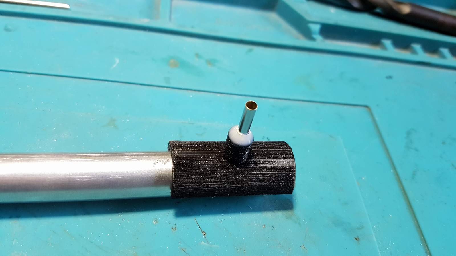

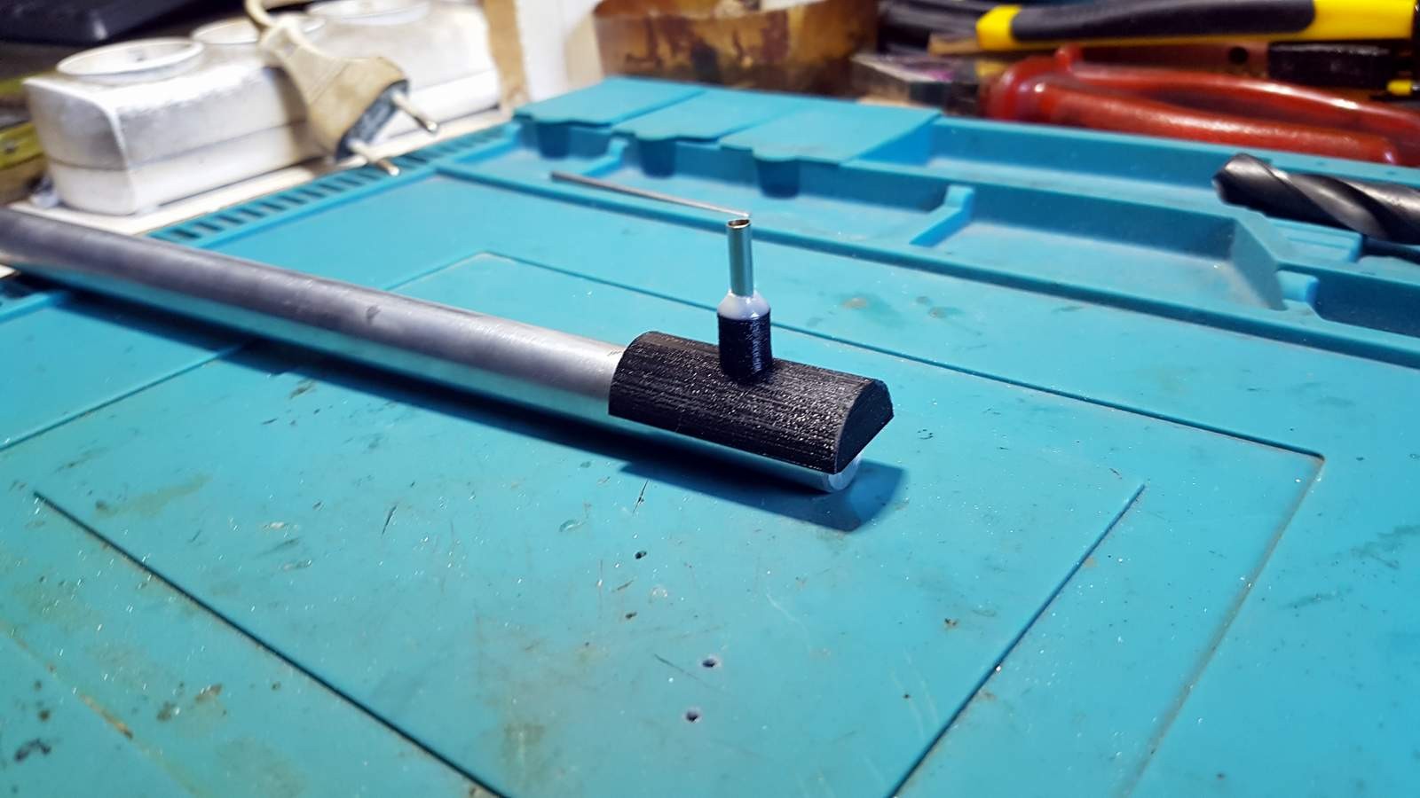

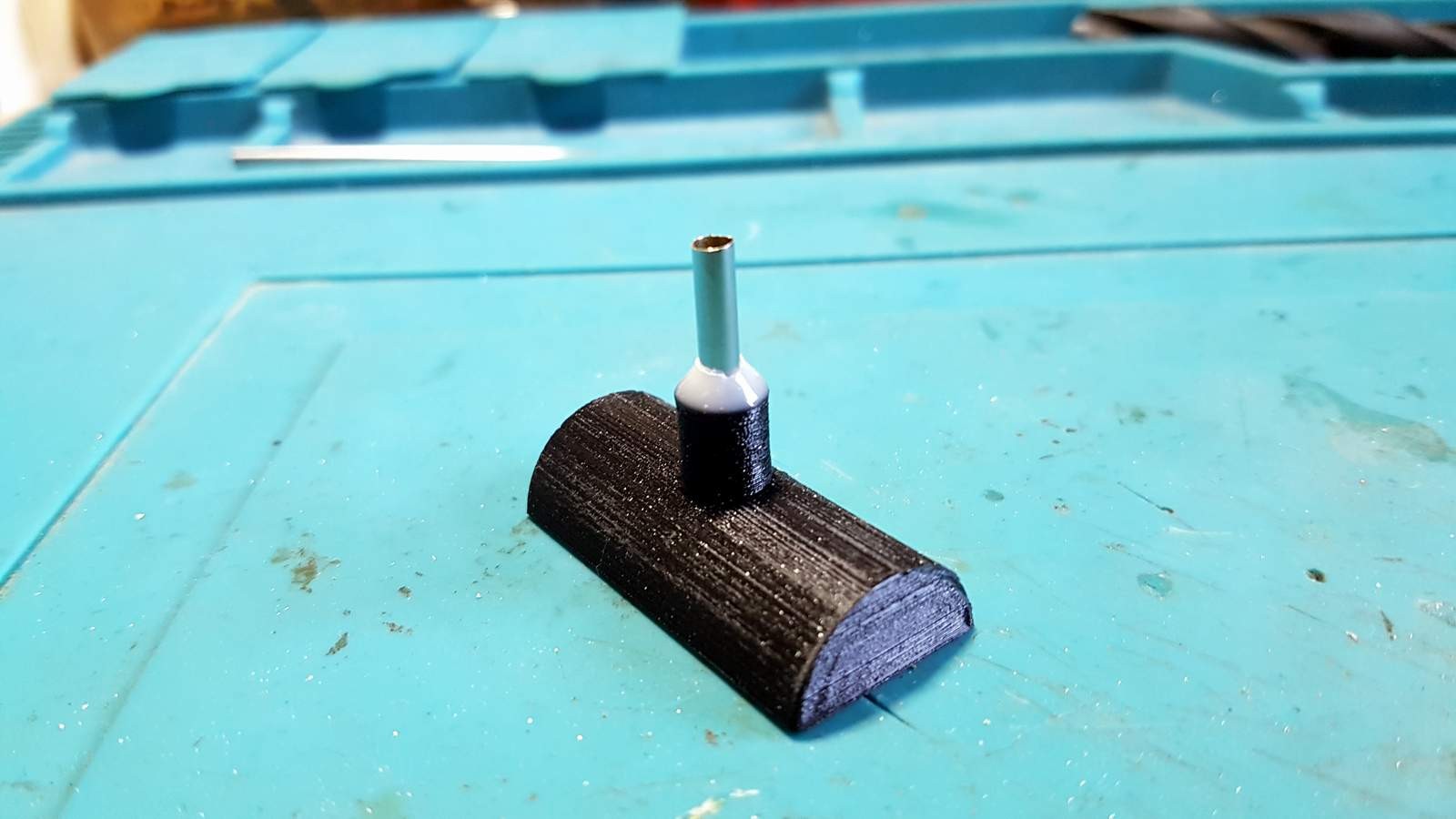

                      "Template" for drilling.
                      The metal accessory, the tube, is from a radio FM telescope antenna.
                      Such antennas are made of several segments, each with a slightly larger diameter.
                      So it's easy to choose a part that will be slightly wider than the diameter of the drill bit.
                      It is glued into the plastic part with epoxy.
                      And serves as a "guide".
