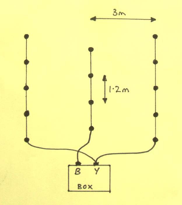

        • I described an alternative probe layout earlier, but thought a picture would explain it better ( attached ).
          Only 14 probes are needed to cover 6m x 5m , the same area as two rows of 10 probes 3m apart. If the electronics box was built with two yellow and two blue sockets, this three-row arrangement would be neater to wire up.
          Electrically, this presents the same ground resistance to the box as two rows of 10.
          Click image for larger version  Name:	Dscf7855c.jpg Views:	0 Size:	25.9 KB ID:	414167

              That's interesting!
                That's interesting!
                Yes, but it reduces the detectable area.
                • In what way ? You're thinking about the area covered by the probes? About the same by my calculation. It depends on how much 'spread' around the probes there is. 10 probes 3m apart strictly covers 9 x 3 = 27 m2 , but in practice may spread 0.5m beyond the ends of the rectangle, giving ( 9 + 0.5 + 0.5 )m x 3m = 30 m2. Whereas the three-row arrangement covers (4 x 1.2 )m x 3m x 2 = 4.8 x 6 = 28.8m2, if you allow some 0.5m spread beyond the ends of the 4-probe line. Which is much the same as the two-row's area. You could always use 5 probes in the middle row and position them directly lined up with the outer rows. Space them 1.25m apart if you like.
                  If you're concerned about detecting near the probes, and getting a signal from them ... I am concerned about that, too. The three-row arrangement 'looks' like 18 probes, hardly any different or better than the two-row.
                  What you could do with the three-row arrangement that's different, is:
                  After running the device for 30 minutes 'charge up' , switch off, quickly remove the middle row, connect the blue and yellow to the remaining outer rows, and re-apply the power. That may help retain the 'charge' , while giving you a 6m wide area to detect with no big metal pegs inthe middle.
                  Speaking of which ... steel probes will ID as 'iron' to a detector ( I hope ), but aluminium probes will surely give what the Yanks would call a 'Quarter signal' . This may or may not be a nuisance.

                        In case of running Depth Doubler; smaller diammeter coil will do. Targets are much more "bigger" under the influence of Depth Doubler, so smaller coils would see such targets.
                        Let me remind; Depth Doubler is also made for nugget hunting (I posted PDF about that earlier).
                        Smaller coils will be more suitable to search the area and yet not to be bothered by the probes.
                        Duraluminum I picked is of very weak magnetic properties.
                        One lose less search area with such probes.
