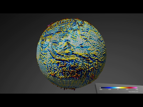

      It's a pity that this was only done in the range up to 1000nT:
        For those interested:
        https://www.ncei.noaa.gov/products/e...anomaly-grid-2

        For example, my area, "X" marks my location...
        Click image for larger version  Name:	mag.jpg Views:	0 Size:	136.1 KB ID:	414142Click image for larger version  Name:	mag2.jpg Views:	0 Size:	174.9 KB ID:	414143
