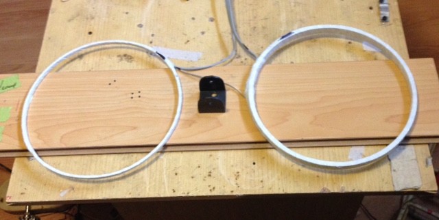

      • I am going to build similar the coils are ready.

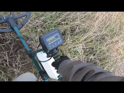

          Thanks Ivconic , but at first glance it appears that this detector is useless . here are some features :
          http://kraftpuls.ru/pages/mg17.html
          This direct digital processing made it possible to obtain high stability and black-color selection. The rate at which currents decay in metal depends on many factors. First of all, on the conductivity of the metal and on its shape and thickness.This is used to cut off small objects, since the current in them fades out much faster than in large ones. Therefore, the reception was made with a delay in order to cut off the metal fines.
          Depth and stability of detection is achieved through pulsed search technology and coil separation.
          There is also ground balance and slow auto-adjustment, this allows you to get rid of interference during search, which is typical for the static mode.
          This is a very easy-to-use device, based on the “plug and go” principle. It does not require adjustments during operation, but if necessary, you can change the threshold and volume. It is not afraid of the frame catching on bushes, that is, there are no false alarms from snags, especially when walking.
          Detection depth of some objects:
          German helmet M-35 2.0 m
          Copper plate 200x200x0.5 mm 1.7 m Passenger car 5.3 m Steel rod diameter 25x500 mm 1.3 m These results are for a standard air test in the field (there is no point in testing indoors due to interference).
          The cost of one set of MG-17 is 80,000 rubles
