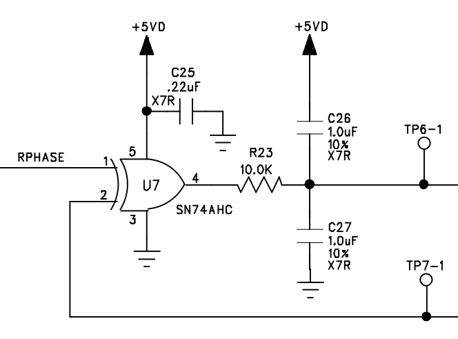

    Guys, hello. Such a problem. Cleaned the device rev 3 2010. And broke the u7 chip. Who has a device with this element. Take a photo please. Or tell me the label.
    It's a 2-input NOR gate. Probably SN74AHC1G02.
      Thank you very much. Do you have a photo of this place?

          Why do I need my photo? Mine is broken and there is no this element. I need to look at the label. on this chip. Because I was told that "probably". A photo of this place would be helpful. I have a photo with this chip but the quality is disgusting.

                that's better. because there are a lot of clones. they are all the same. except for the earliest ones, they contain u7). Believe me, I have been looking for the name of this microcircuit for a month now. And most likely found.
                  Sorry, It's not a NOR gate, it's an XOR gate, SN74AHC1G86. I don't have a photo. U7 was placed on early boards but it is omitted from later boards. It feeds one of the clocks to the micro but even on the early boards that have U7 installed I believe it was not actually used.

                          I work for First Texas so I have the schematic. It has an incomplete part number:
