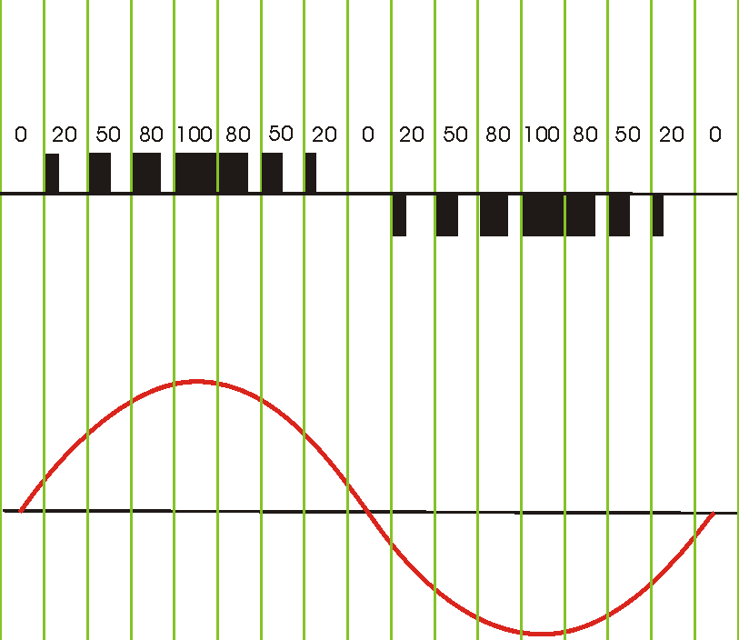

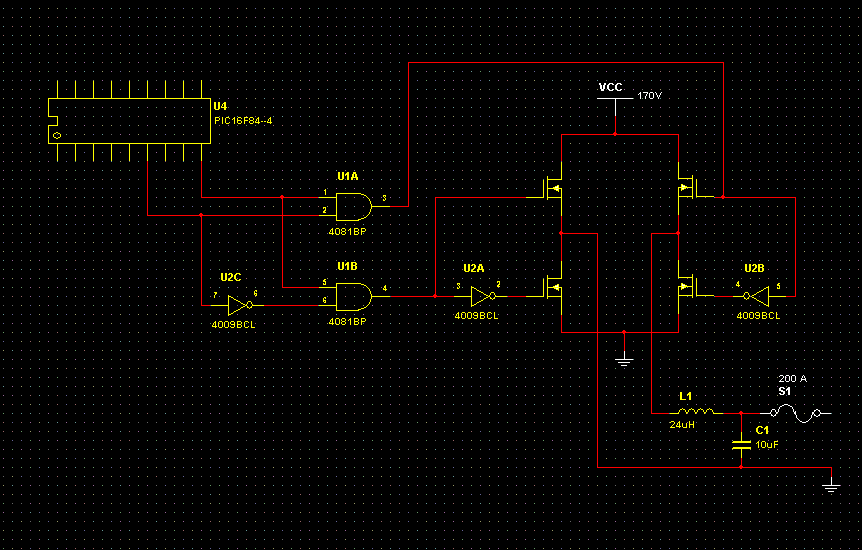

            The inverter also has to be very efficient, so as not to waste the 2kw (hydro) input to the battery bank. A PIC microcontroller (PIC16F62 will be used to create the pwm signal with its built in pwm module, which will be modulated with values from a sine table. External gates will be used to send the pwm signal to opposite sides of the H bridge to generate a complete sine wave.
            Pin 9 of the PIC is the PWM output pin.
            Pin 6 determines which half bridge the PWM signal goes to.
            The two ground points in the schematic are isolated from eachother... the 170v dc supply will be floating.
            The idea is that when one side of the H bridge is being sent the pwm signa, the other half will be tied to ground. This method of modulation should result in the below waveform.
            Numbers above the pulses are duty cycle.
            A high pulse means the lop left and bottom right side of the H bridge are ON.
            The middle line means both the bottom mosfets are ON, shorting the ouputs to ground.
            A Low pulse means the bottom left and top right mosfets are ON.
            All of my ideas/theories are open to question... this is by no means a finished project, im sure many faults will be discovered along the road.
