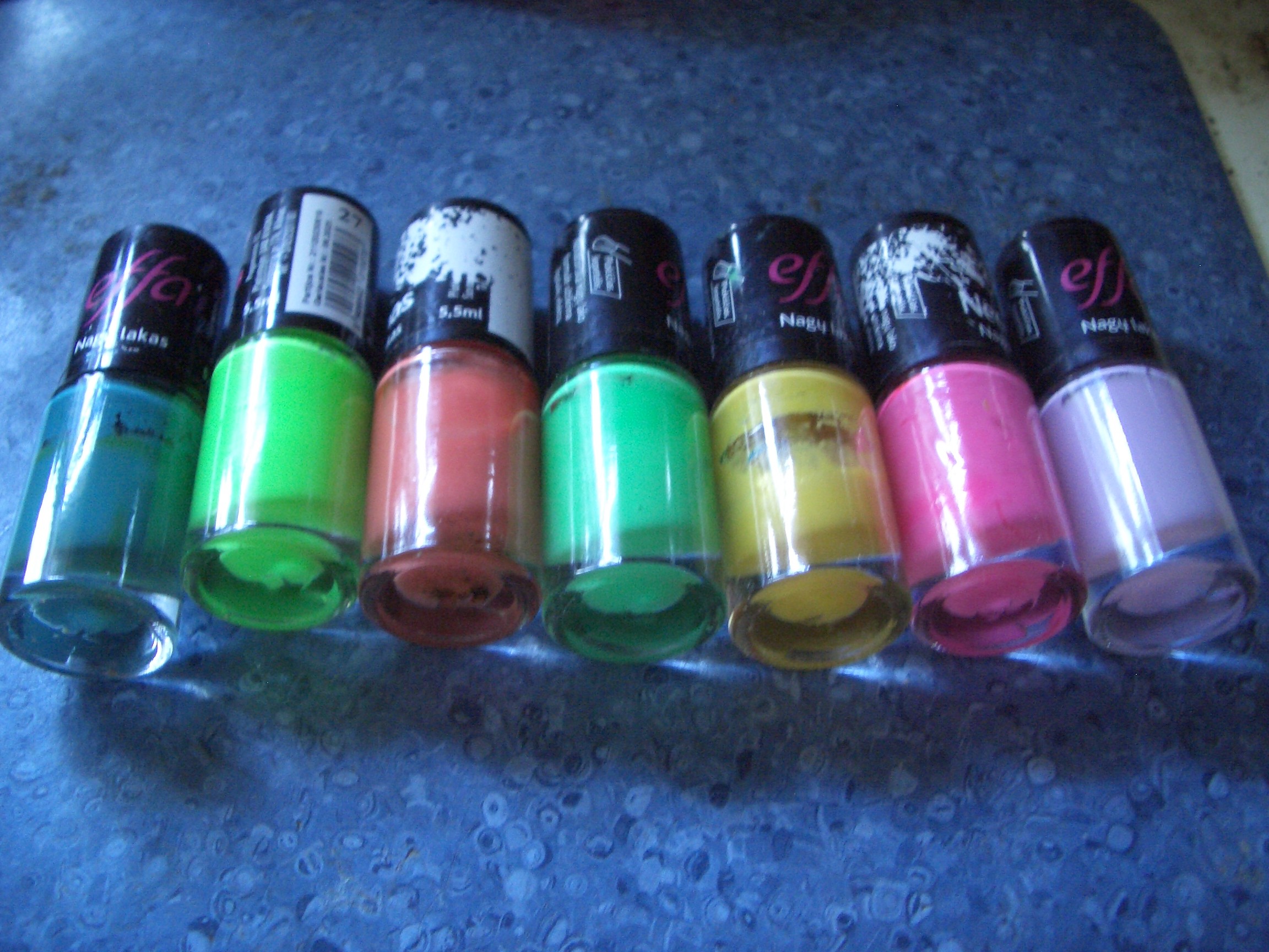

      ok. i give you simplest rules but useful. shoot on camera every your step. you must be back all wires sure on their places/pads.
      use/buy women color varnish paints to mark wires. then you do not mislead one white wire with another white wire never.
      also, mark by small point all trimmers you see on board. then if you will twist one you always can set it to first/fabric tuning position.
      ​Click image for larger version  Name:	CIMG7534.jpg Views:	0 Size:	733.4 KB ID:	415469
        kt315
        this is a cool trick for wires...
