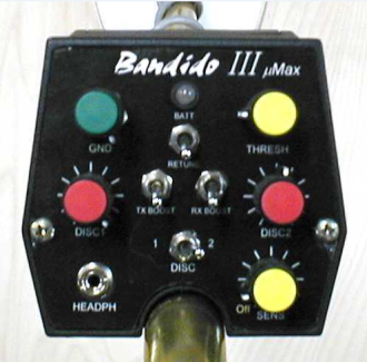

    Hello, there are such files, as I understand their author is a man from France. He made Bandido for himself and therefore called it Bandido III. Maybe someone knows the details? Maybe someone made himself the same? I would appreciate any information. Thank you.

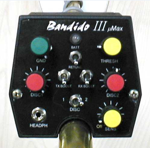

        "HEADPH" !!!???
        What a laziness!
        Or... spectacular talent for abbreviations!
        :rotfl

          And I especially don't like Tesoro's tendency to put potentiometers, switches and buttons close to the front of the pcb
          and connect them with a bunch of wires.
          That's why I haven't ordered those pcbs to be done yet.
          I'm postponing everything because I intend to put the potentiometers (at least) directly on the pcb, which will certainly
          increase the dimensions of the pcb itself.
          And the second, more important reason is the production of the coil. I struggled with it too much and now I no longer have the will to do such a thing.
          If I come across an original one; I might decide to make one.
          By the way, I've had 2-3 original Bandidos so far. I'm not impressed with the depths. Everything else is correct.

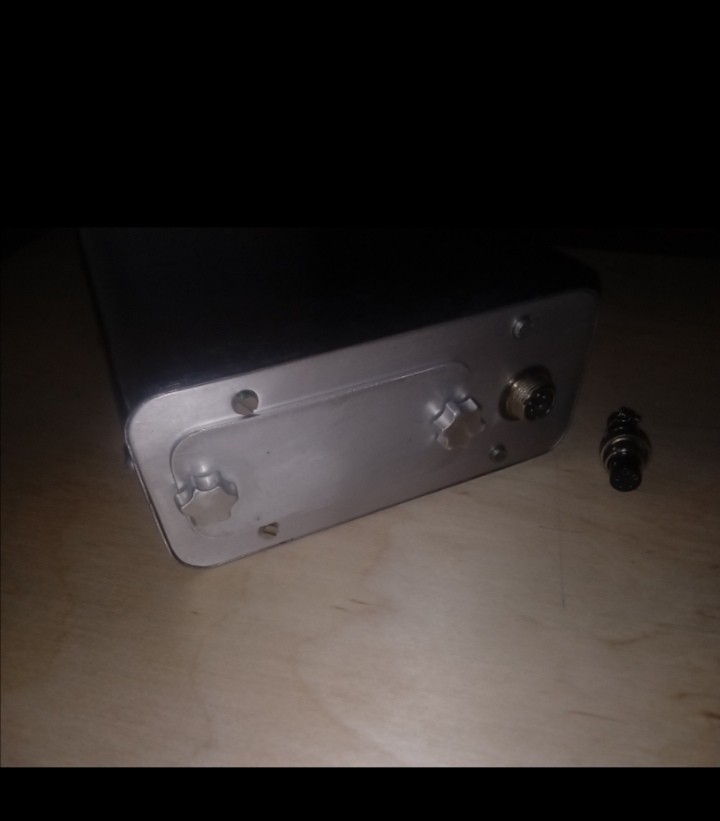

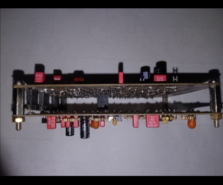

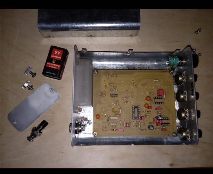

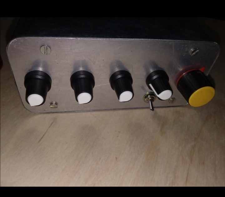

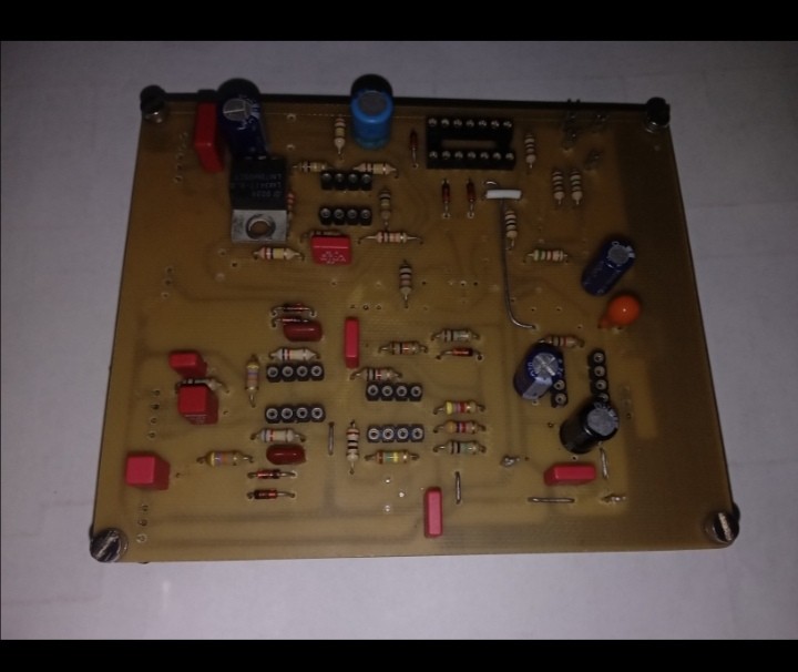

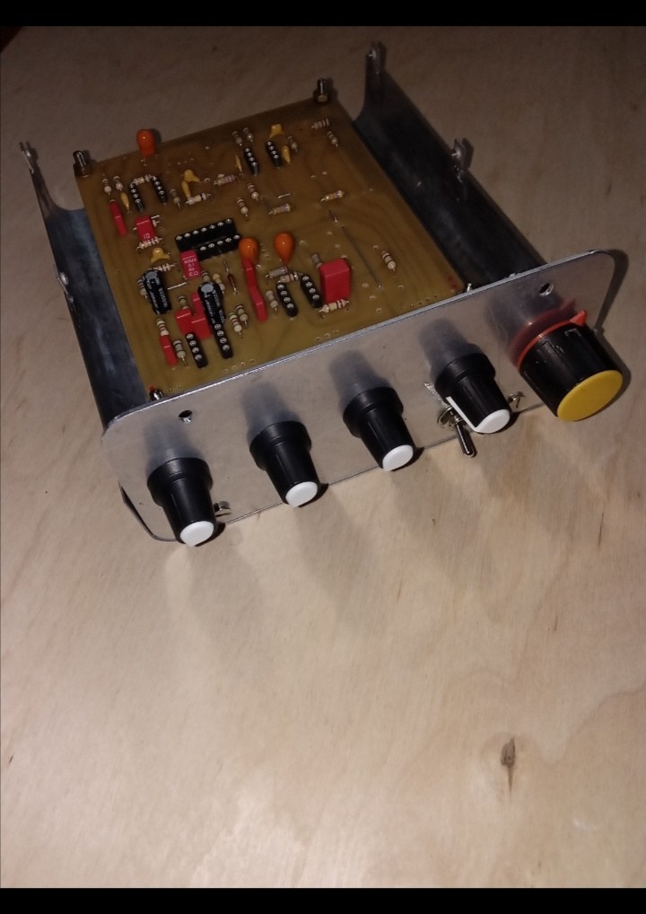

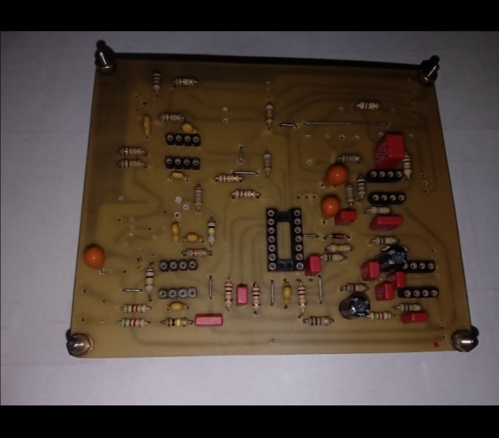

                it is just a project ... i do not see real board soldered and checked.
                  Almost soldered, but not yet tested - there is no time. I asked a question about something else - read the first post of KT315. If this topic is not needed, I ask the administrator to delete it.

                        Neat and tidy!
                        I like it!

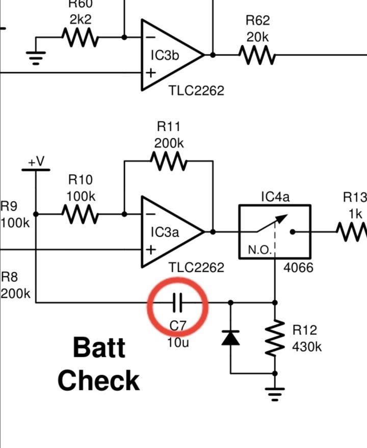

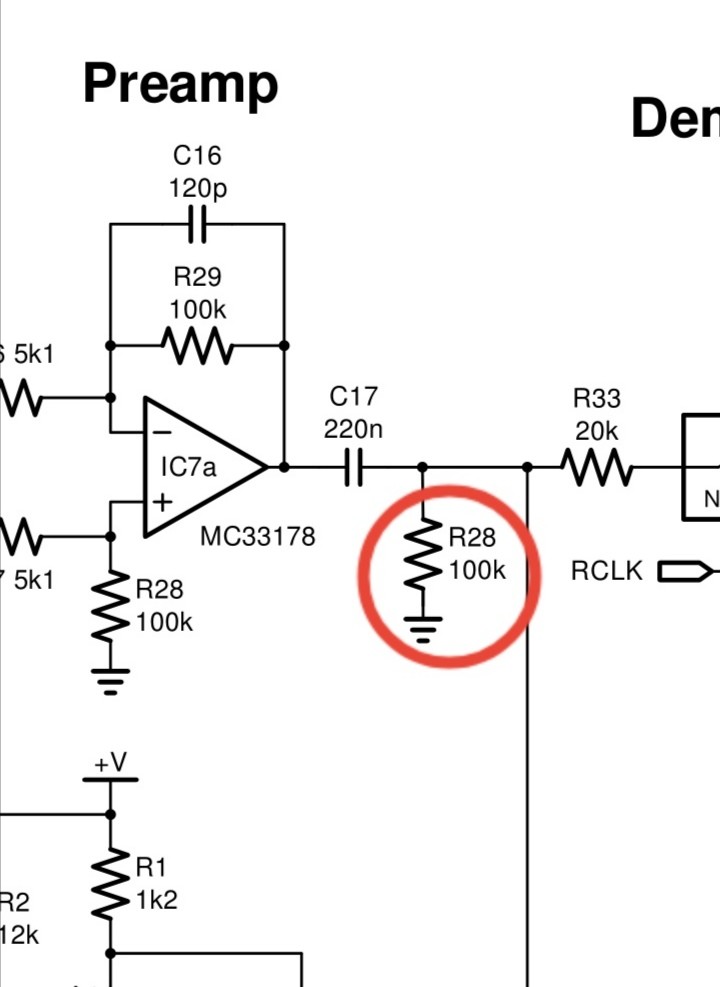

                          Я хотел бы задать несколько вопросов о вашей схеме Carl. C7 является ли этот конденсатор не полярным электролитом? Резистор R30 с номинальным значением 1k, у вас ошибка печати R28 100k? Правильна ли емкость конденсаторов C10, C13, C14, C16, C18? Является ли это оптимальным значением емкости? Thanks.
                            Translated:
                            "I would like to ask a few questions about your schematic Carl.
                            C7 is this capacitor a non-polar electrolyte?
                            Resistor R30 with a nominal value of 1k, do you have a R28 100k print error?
                            Is the capacitance of capacitors C10, C13, C14, C16, C18 correct?
                            Is this the optimal capacity value
                              C7 can be anything you like, it makes little difference. I would just use a ceramic cap.
                              Yes, it should be R30 @ 1k.
                              No idea on the other caps. These were measured values but I don't remember if I took the caps off the board to measure.
