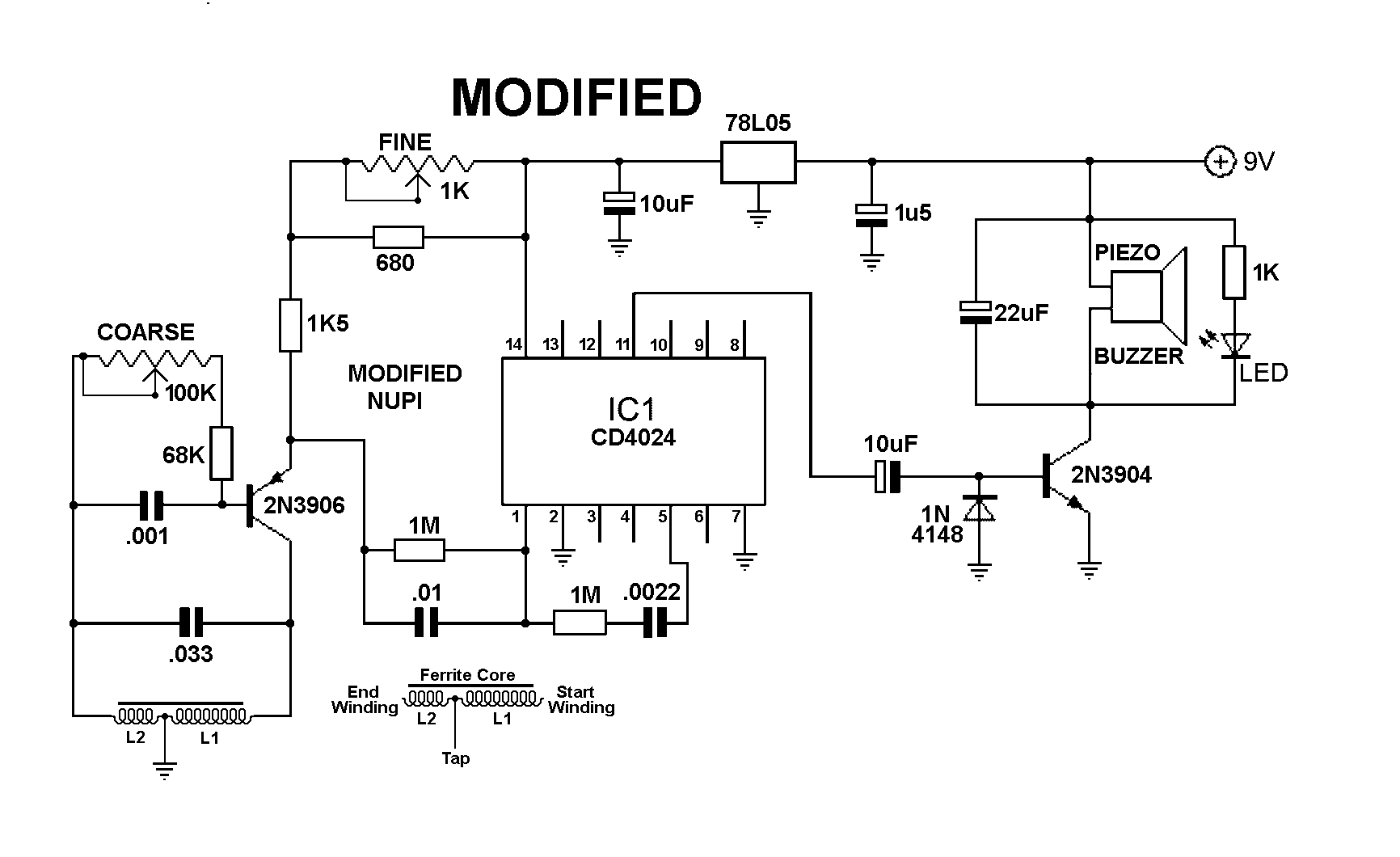

    Does anyone know if there is a pinpointer circuit that is analog and has automatic sensitivity adjustment?
    I made two different project successfully - Minimax and Nupi and I got excellent results, but... Minimax doesn`t have static/non-motion mode of operation, and Nupi`s sensitivity needs to be adjusted manually constantly.
    It would be good, if there is such a useful project, no matter how complex the scheme is.
    Or if there are workable solutions already achieved by someone, in which the above mentioned deficiencies of the cited pinpointers are solved?

      https://www.youtube.com/shorts/Tnj76--DixU, it was shared in #662 / https://www.geotech1.com/forums/foru...n-chain/page45

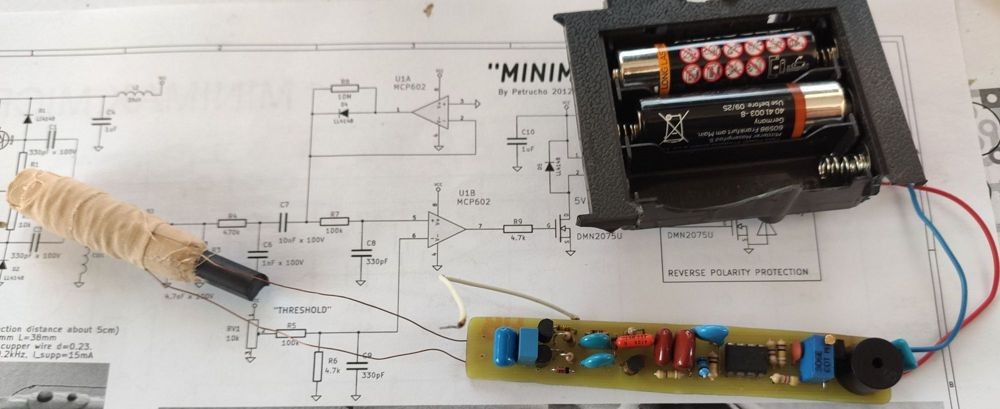

      Also, I have very good results with minimax pinpointer- unfortunately, currently I am difficult to find the video in my PC...
Name:	My minimax.jpg
