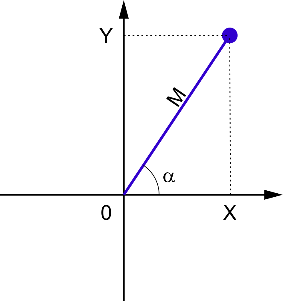

    The resistive channel (R) is actually the quadrature channel (Q) and is used for the all-metal signal. Normally you want to use a ground-balanced version of the R channel, what I call the G channel. That way the AM signal is immune to ground. The disc signal uses both X & R, as Altra says.
      sometimes they use Ux and Uy

        Would you look at the id differences between All Metal and Disc modes? What is the reason of this? How can disc mode give such a stable id? Are there different filters used?
        Note: The device I tried works as direct sampling. It takes the TX clock from the TX driver and transmits it to the ADC and the data goes to the processor. There is no analog demodulator.

          Without access to the code I can't say what is going on. Typically Disc mode uses 2nd derivative signals while AM is 1st derivative or maybe even static.
            Carl, I tried using the 2nd derivative and the 1st derivative, but I could not see any difference in obtaining the target id. I can't understand the difference in the id list I wrote above.
