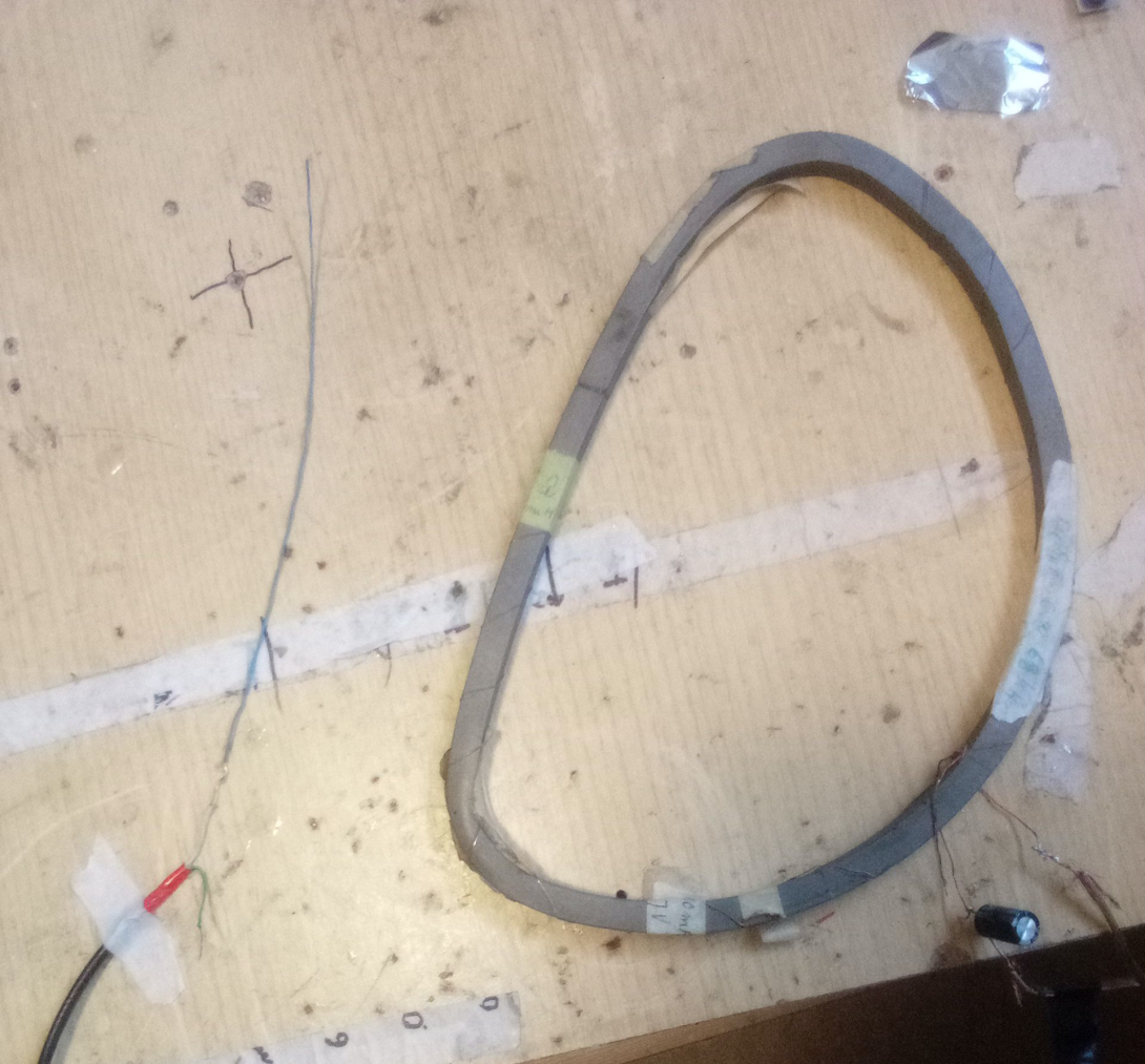

              And I think the coil and oscilloscope should work, the simplest = just speaker, short the speaker terminals with a loop (20cm)

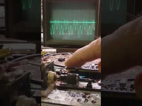

                amplitude is proportional to frequency = let see, random Tx coil, frequency from 20 kHz to 5 kHz
                Resonance at 12 and 6.2 kHz, the rest of the band is more or less flat.
                For a constant voltage driven TX coil, as you increase the frequency the TX current decreases (I = V/wL), and so the TX field strength decreases. At the same time, the induced RX voltage is proportional to the derivative of the TX field (ε = -N*A*dB/dt), which is decreasing in amplitude but increasing in frequency, so the RX voltage stays constant. So even though you see a constant amplitude on the pickup coil with increasing frequency, the TX field is steadily decreasing. That is why you cannot directly compare pickup coil results at different frequencies.

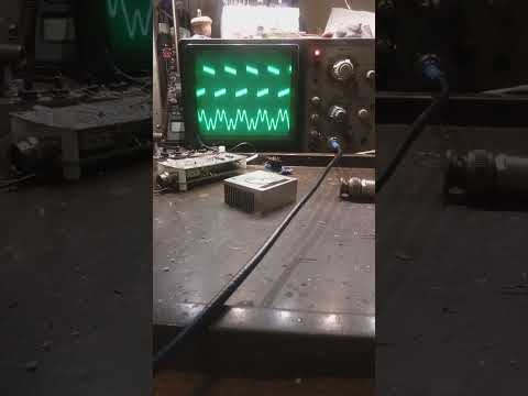

                  Let see part 2

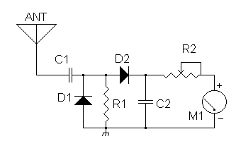

                  With frequency changing meter needle doesn't move. I agree with theory, the current should change but is not. I may investigate that some day.

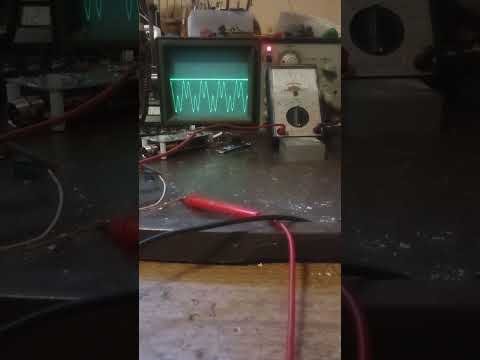

                    Let see part 3
                    Instead a coil I using piece of wire​, ANT straight to the oscilloscope.

                    top ANT = no amplitude change
                    bottom pickup coil​ = no amplitude change
                      What current are you measuring? The overall TX circuit current, or just the current through the coil?
                        What current are you measuring? The overall TX circuit current, = generator total current current, = 100mA.
                        I have also 1 Ohm resistor in Tx driver, used as current sensor, it is showing 0 mA, so current it is very small, for instance another coils can drawn over 100mA (at resonance ). The coil is 70 turns, 3mH, capacitor in series with coil 1000uF.
