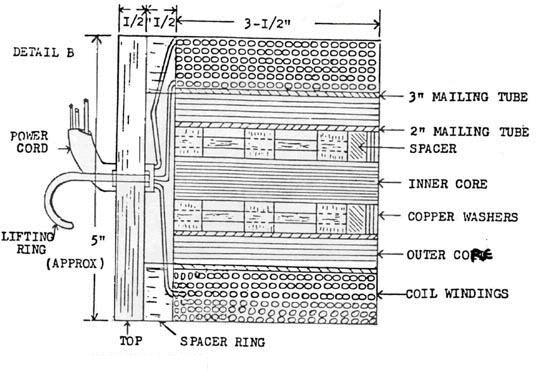

              The old article was called "The Magnetic Print" or some by the style.
              No only for gold, yes for non-ferrous metals.
              Here the constructional article (similar to "The Magnetic Print"):
                GOLD MAGNET
                Maybe someone from this forum with the electronic expertice can build this from the above diagram and schematics and then report to us the results?

                          Non ferrous Magnet
                          Hi everyone,
                          It is possible to attracked non-ferrous metals. It works like a shaded pole motor. The core of the electro-magnet has ferrous and non-ferrous material.
                          By warping the magnetic field the eddy currents in the non ferrous target take on an opposit polarity as the magnet and therefore attract.
                          see this link for a interesting book on the subject.
                          Regards Mark S.

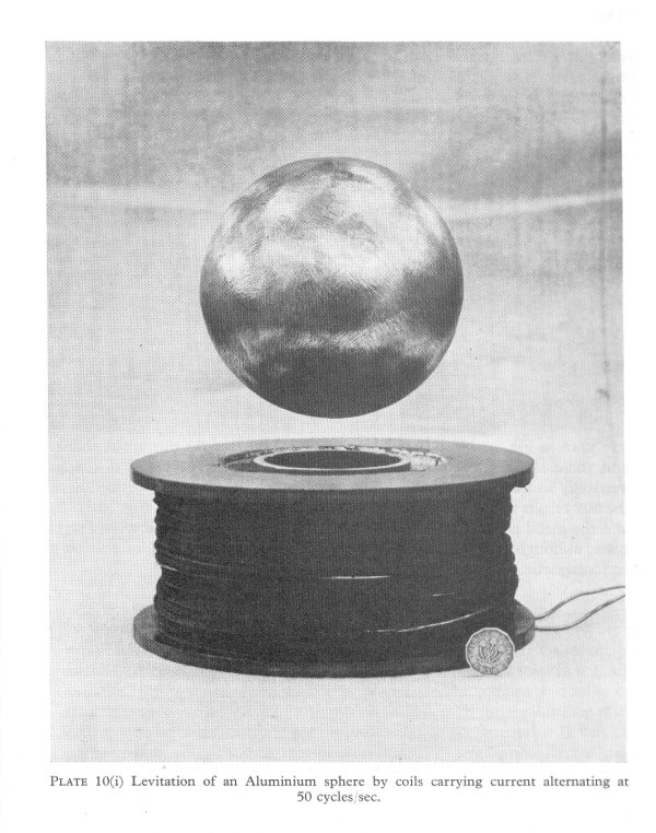

                              The post above by Mark S. regarding shaded pole motors triggered a dormant memory. I have an old book by the late Professor Eric Laithwaite called Propulsion Without Wheels (published in 1966 and costing 63 shillings) which discusses the linear induction motor in some detail. Chapter 10 deals exclusively with magnetic levitation. There is a superb photo of an aluminium sphere being levitated by a coil carrying an alternating electric current. The levitating coil arrangement can either consist of an inner and outer coil (with the inner coil carrying a current that lags in phase behind the outer coil) or one coil with the inner coil replaced by a copper tube. The latter case is the shaded-pole equivalent of the former. The two coil version looks very similar to the first design posted in this thread.
                              Prof. Laithwaite says that "whilst the main part of the sphere has lift forces, the lower central portion is actually attracted to the coil. [The photo] shows an aluminium sphere suspended in this way. This effect can be emphasized by means of a small piece of aluminium held just above the centre of the coil system when the sphere is removed. If the metal is attached to the arm of a balance it will be found to be attracted when the current is switched on. This attraction of conducting objects to a.c. magnets is opposite to what one might expect after performing jumping ring and levitation experiments.".
