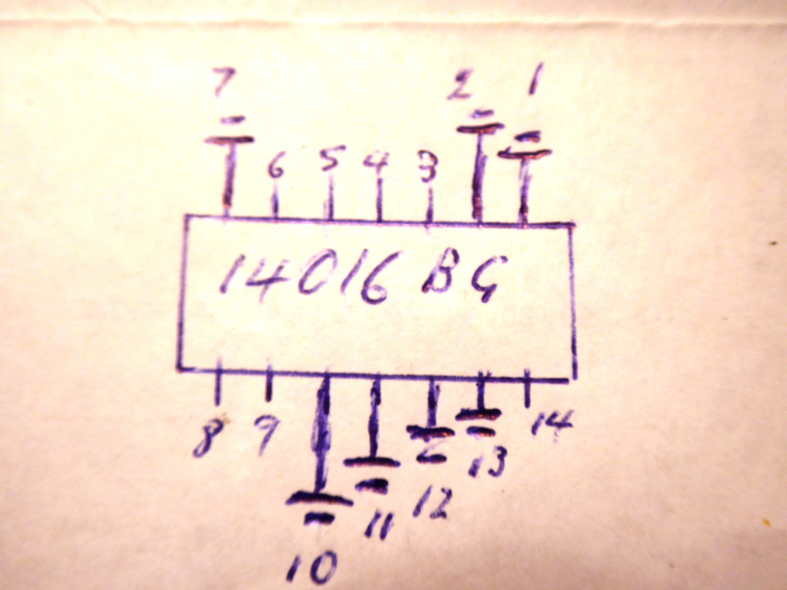

      Connector pin 4 goes by a series cap and a 2002 marked resistor to pin 4 of 14 pin IC 140168G but I don't recognise this type of IC.
        140168G = maybe B not 8 = CD4016 SMD ( MC14016BG )

          It looks like you should have 3 pins connected to ground ?

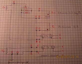

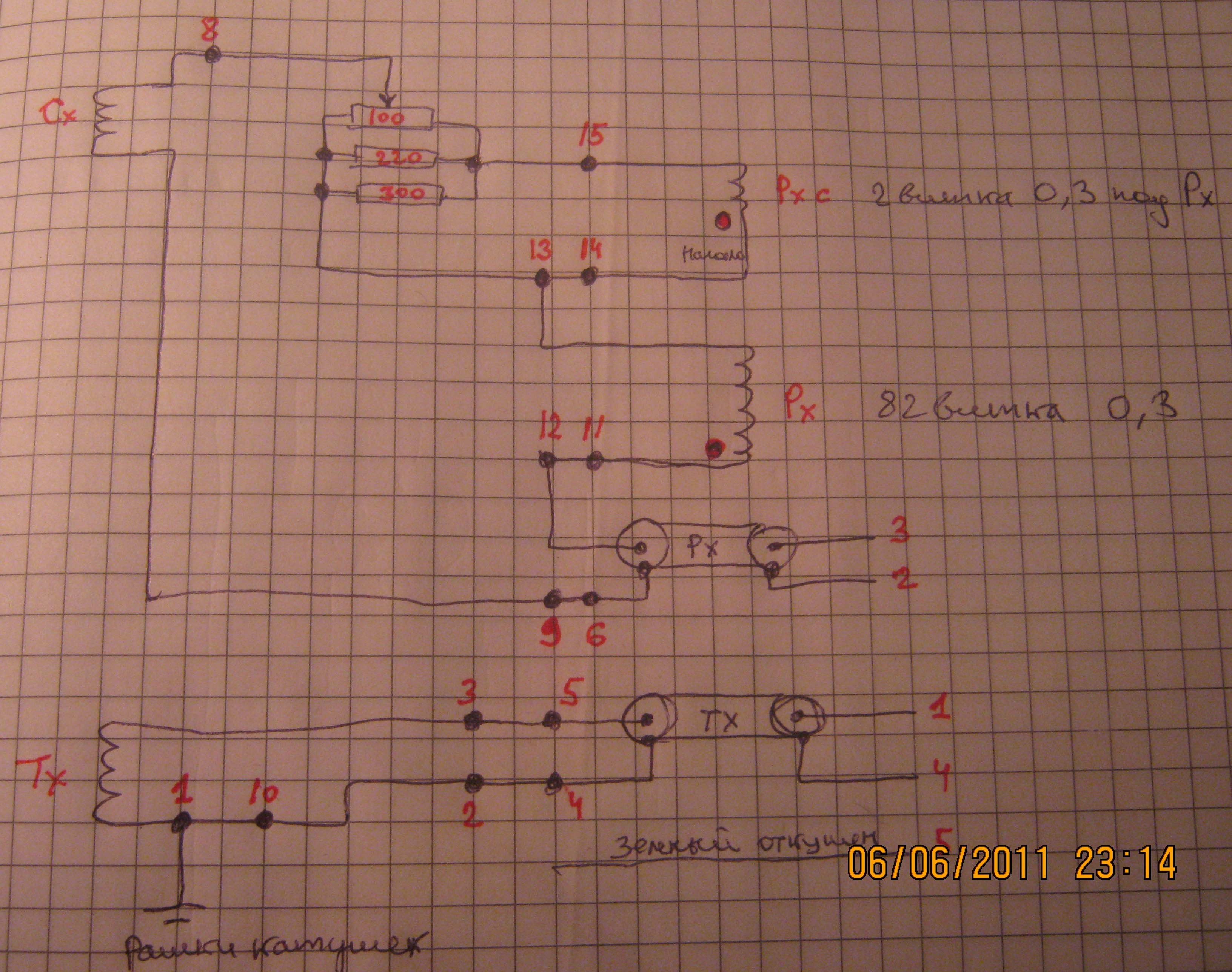

          5. Receiver OP376, and transmitter LM386 – no changes found.

ID:	420243 original circuit of the coil
              Click image for larger version  Name:	ACE_250 coil_sch.gif Views:	0 Size:	6.8 KB ID:	420240Click image for larger version  Name:	ace-250-coil-diagram2.jpg Views:	0 Size:	172.3 KB ID:	420241

                  Thank you for all the images and support. I have verified that the Demodulator, bilateral quad switch 14016BG has 7 pins to earth as in the pic attached. Pin 7 is not showing in the diagram but the drive from the dual voltage comparator LM393 pins 1 and 7 seems to be in order. I am still none the wiser but I have now a clean sound from the speakers after I have stabilized the coil connector case and everything is tight with no spurious sounds when wiggling the coil lead or the plug, which establishes without doubt that there are no issues with the coil or the connector. Furthermore, with the detector switched on and selecting any of the programs, pressing the "pinpoint" button that I have previously mentioned, there is now the normal background low sound, and on passing a large piece of metal to no higher than 4" it does pick it up with with a high tone but no small metal reaction whatsoever, and none on any detecting mode to any size or types of metal. So there is life in this circuit and I will have to wait until my friend gets back from holiday to access his oscilloscope.
