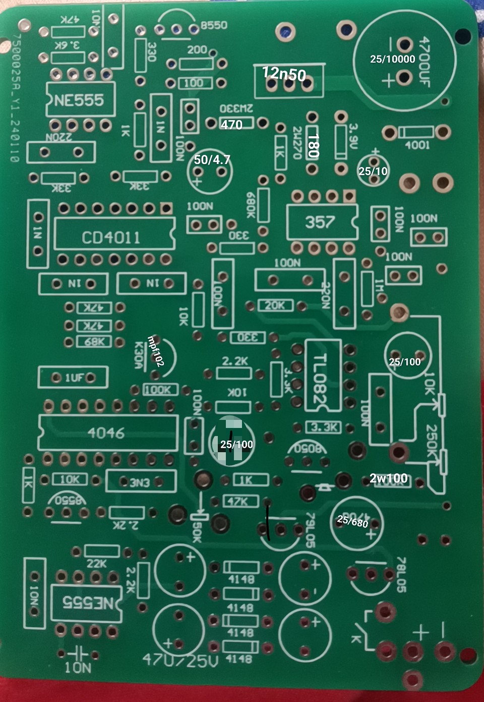

    My PCB board, I hope to improve it, but I am a beginner. Can someone help me draw a schematic
    I made the following modifications

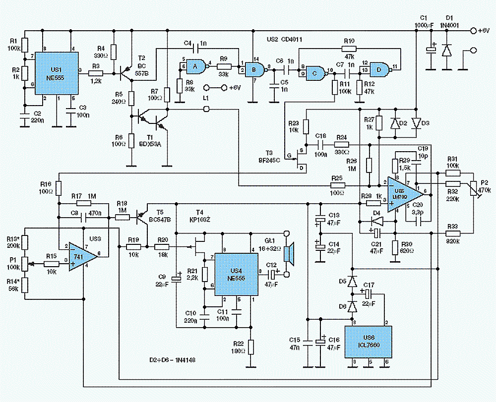

      What is the name of the detector? From the IC's it could be a mix out of PI Polones with VCO.

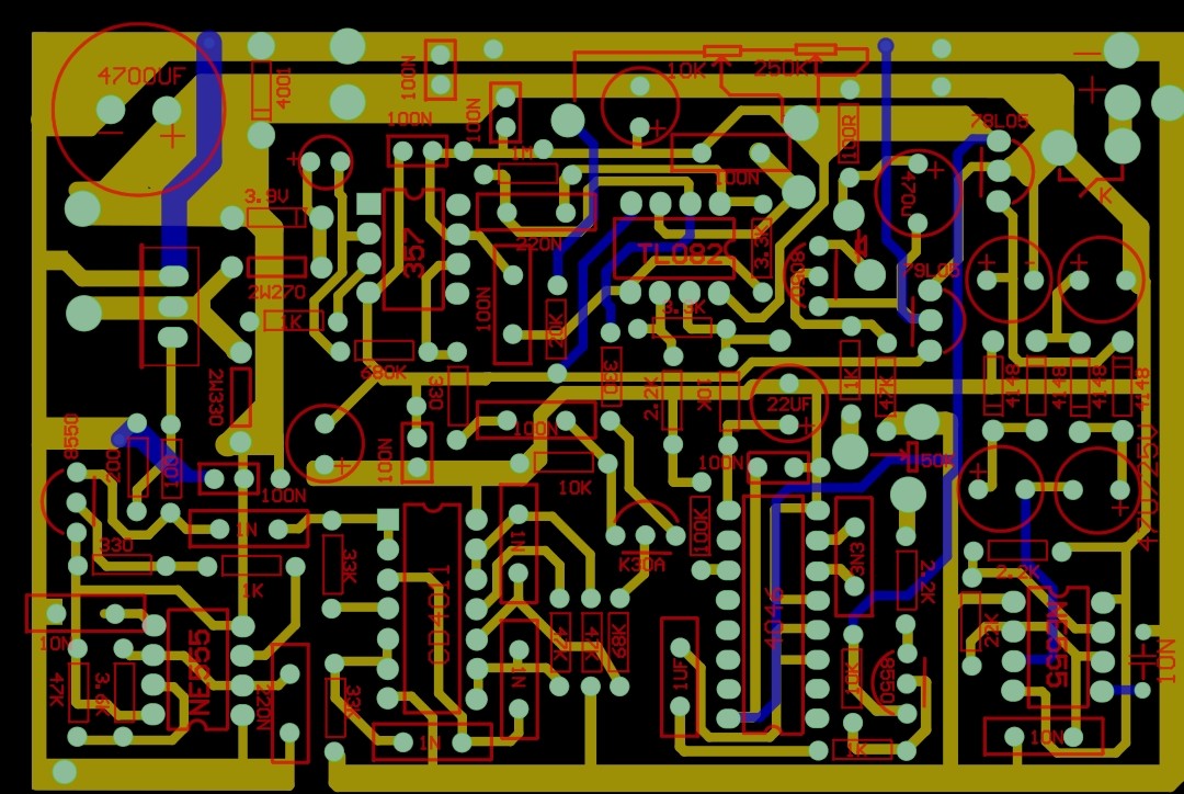

        what CAD soft you use? i can not open your .pcb file.
          Altium Designer Using this or jlc EAD
            Opened the circuit diagram
              I see that the intention is to adapt a VCO to the Polish pi circuit and for that it is using the VCO of the 4046 but as you can see there are a lot of pins left it would not be more interesting to use a dedicated Ci with just VCO I would use the LM566.​​​​​
                I also feel that it is astonishingly similar to PI Polones
                  Proscan was with it.
                    I used 2x2m square coil to find a shovel in 2m air
                      Hi Emersonpaz​
                      One of the main reasons for using a CD4046 instead of an LM566 is simply availability and price. The LM566 costs at least 10 to 15 times more than a CD4046. Both have IC's have a good VCO built in.
                        You're right, friend, I hadn't noticed the price difference between the Ci's.
