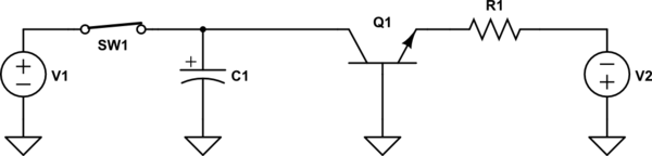

              I've never heard that U can mean volts, but if it does then you would not mix U and V together. In this case, it means that a 100uF cap charged to 400V will discharge in about 5 seconds. This implies a constant 8mA of discharge current.
              Another possible explanation is that it's made in China, and often the English labeling (and instructions) gets completely butchered, and you have no idea what was intended.

                  I am well aware that U is taken to mean volts in Euro tech markings ... However when its a chinese manufacturer and the OP said that it was marked 100U 400VOLTS ~~5S then that is chinese for 100 "u" ( ie microfarad ) at 400 volts in approx 5 seconds. If they are using a constant current discharge current internally then you can use this to calculate the discharge time for other caps.
