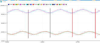

      bias
      Click image for larger version  Name:	image.png Views:	2 Size:	4.9 KB ID:	425533
      What could be the reason for this? = wrong reference signal for phase detector

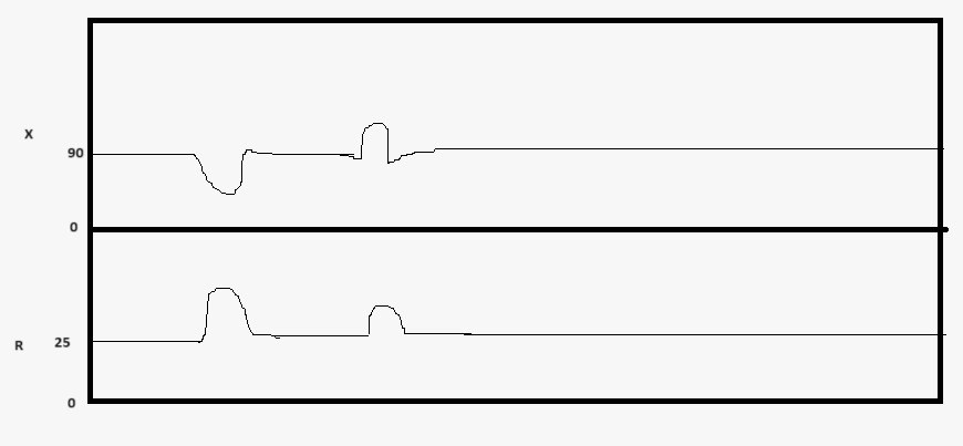

              What do the X & R signals look like as you sIep a target across the coil?
              • The X and R signals are seen in the following figure. When I pass a non-ferro metal, I got both of them going high, when I pass a ferro metal, one channel goes high and the other goes down. The representation of the signals are given here​

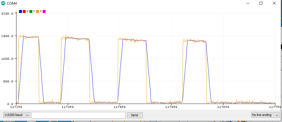

                    what about ?
                    Serial.print(X);
                    Serial.print(R);
                    R and X

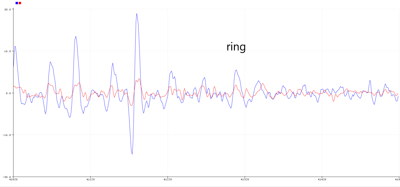

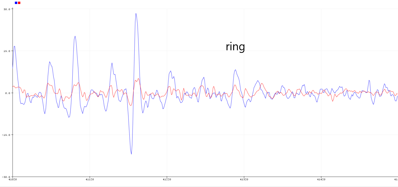

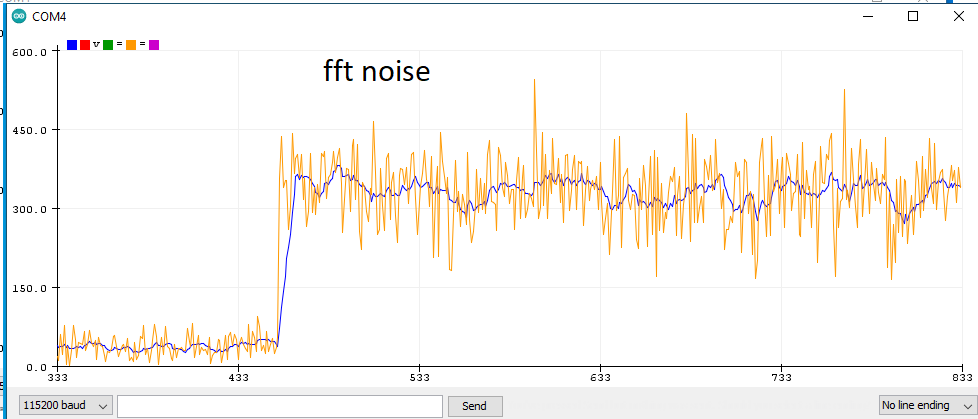

                    Click image for larger version  Name:	image.png Views:	0 Size:	34.5 KB ID:	425558

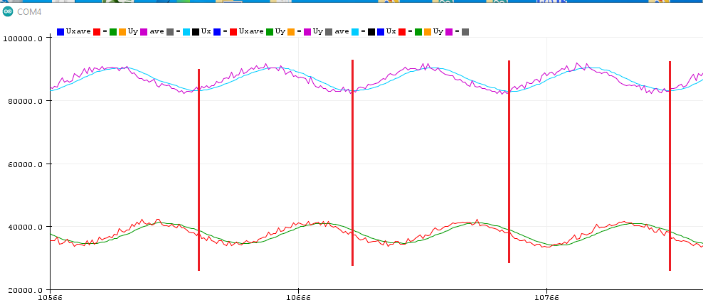

                    magnitude and VDI, gold ring
                    Click image for larger version  Name:	image.png Views:	0 Size:	92.3 KB ID:	425557
                    I take FFT, and take the complex value corresponding to the bin of 15 KHz. At that bin, I get the highest amplitude as expected. = fft bin 98 15.2 kHz
                    Click image for larger version  Name:	image.png Views:	0 Size:	38.3 KB ID:	425559Click image for larger version
                    I get about 7-8 id. What could be the reason for this?​ = phase shift of your ground is - 74​​ deg.
