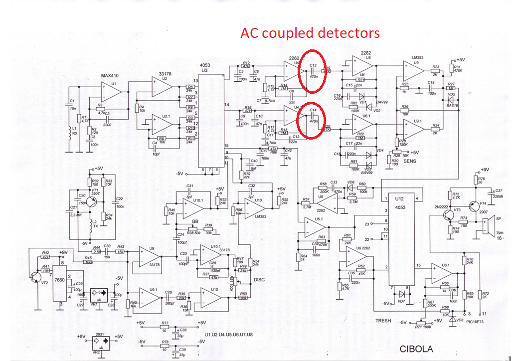

    to detect metal you need to swing the coil all the time because synchronous detectors are AC coupled, in static mode (pinpoint ) they are DC coupled.
    AC coupled amplifiers are not sensitive to DC drift.​

      Everything is right. We're talking about the same things. I wanted to clarify this. For a fully analog detector, what you have indicated is undoubtedly true: the timing of the demodulators depends on the TX signal. Therefore, the system automatically adjusts to the "changes" in the temperature caused by the temperature and something else. I am interested in the question in relation to detectors with fully digital signal processing.
