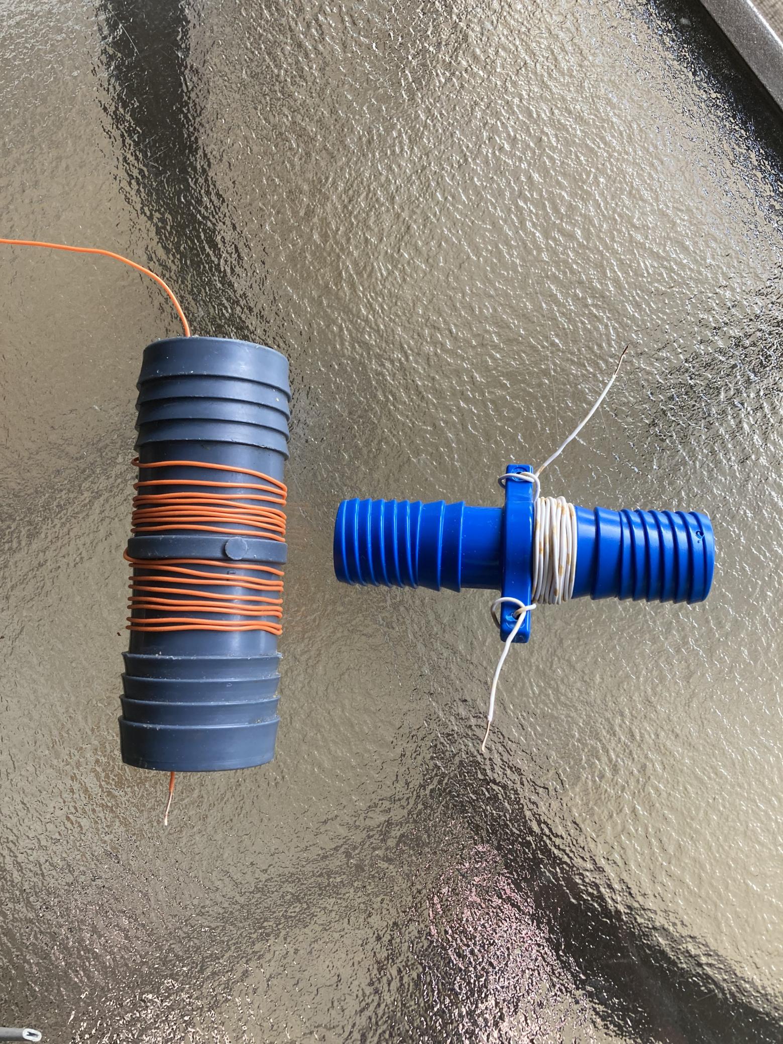

    Just wind up a small (1-2 inch) coil with 10-20 turns of wire, preferably small gauge (24awg or smaller). Connect it to an oscope probe, you may need a ~1k damping resistor if it rings. This will give you the derivative of the TX field, and will be the same waveform as the TX voltage driving the coil.

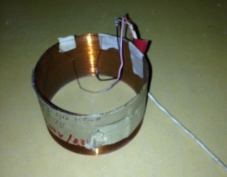

      Large coil is 1 1/4" diameter with 20 turns. Measures 0.01 mH and 0.4 ohms.
      Smaller coil is 13/16 diameter with 25 turns. Measures 0.01 mH and 0.3 ohms.
      Used cat 5 solid core wire. Not sure the gauge.

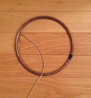

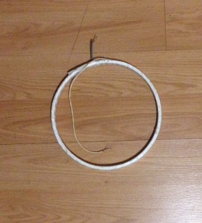

        Any coil you have, with approximately 100 t, any wire diameter.
        loop antenna

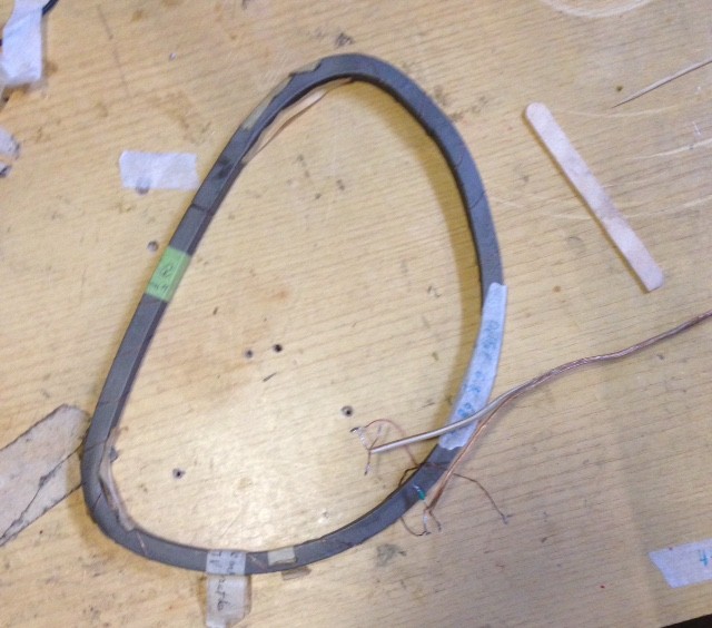

        Click image for larger version  Name:	coil mosfet.jpg Views:	0 Size:	83.1 KB ID:	424290Click image for larger version  Name:	coil2.jpg Views:	0 Size:	96.0 KB ID:	424291Click image for larger version  Name:	cu rx.jpg Views:	0 Size:	23.6 KB ID:	424292Click image for larger version  Name:	tx3b.jpg Views:	0 Size:	22.5 KB ID:	424293Click image for larger version

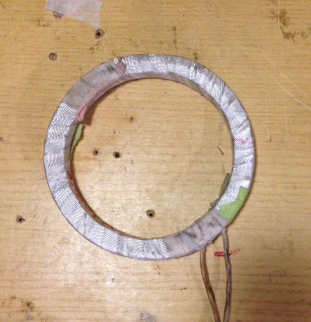

          Think I'll try one of my mono coils from the White's TDI SL.
