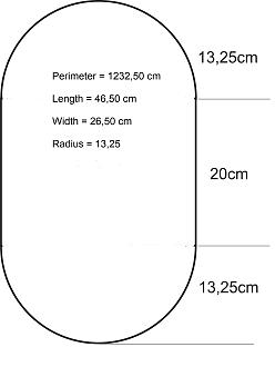

    • Coils dimensions are correct ?

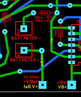

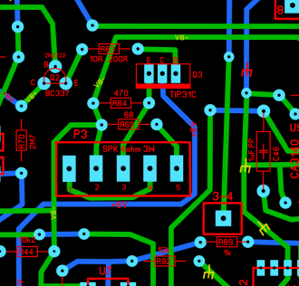

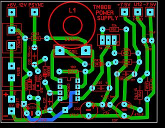

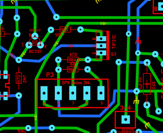

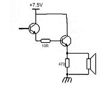

      • Some modifications:
        Power Supply changed 78S40 -> MC34063
        Click image for larger version  Name:	TM808 mc34063.jpg Views:	0 Size:	396.2 KB ID:	413830
        Audio Amp :
        Click image for larger version  Name:	808audio_amp.jpg Views:	0 Size:	19.7 KB ID:	413825 Click image for larger version  Name:	808audio_amp_mod.jpg Views:	0 Size:	19.5 KB ID:	413826
        Audio Amp PCB :
        Click image for larger version  Name:	TM808 tip31.png Views:	0 Size:	114.7 KB ID:	413827 Click image for larger version  Name:	TM808 tip31 mod.png Views:	0 Size:	136.9 KB ID:	413828
        Batt Meter Resistor :
        Click image for larger version  Name:	TM808 +VBatt.png Views:	0 Size:	74.6 KB ID:	413829

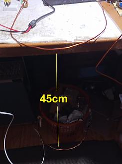

              • On collector Q1 20V (on the bottom ), on Rx testing coil 0.2 V = 5 time less than in DD coils = not good.

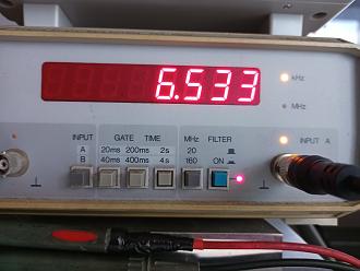

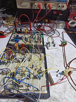

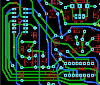

                • Tested with Active XTAL 25.6Khz (6.400Hz) and Pasive Xtal 420Khz (6.535Hz) both works fine !
                  25.6Khz + CD4024 = 6400Hz
                  420Khz + CD4040 = 6535Hz
                  Little change on circuit for 420Khz (photo), original circuit s/schematic don't work for me ..
Name:	420Khz XTAL CD4040 pcb.jpg

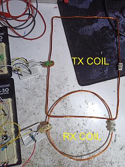

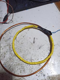

                  • Pito, join both coils at side, not at center. :

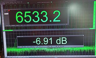

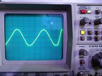

                    • RX SIGNAL 14V :
                      PROBE COILS (6.533Hz) :
Name:	TM808 PREAMP RX.jpg

                        • Originally posted by berreizeta View Post
                          Click image for larger version  Name:	IMG_20230829_175050_574.jpg Views:	26 Size:	441.7 KB ID:	414490
                          The red coil with green tape and LED is for testing how much power is emitted, Rx testing coil is under the table on the floor.​
                          I have two questions.
                          1. What are the values of Tx, Rx capacitors
                          2. Can you put the yellow coil under the table on the floor while the Tx is on it?
                          What amplitude do you have on the that probe coil?​

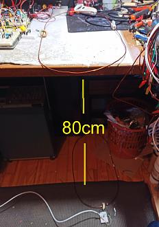

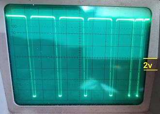

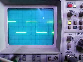

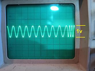

                          • My coils are not final, they are just to test the circuit, they are not perfect.
                            I do the calculation of the capacitors/frequency with:
                            https://ekalk.eu/lc_es.html
                            With the coil on the ground at 80cm, barely 1V reaches the circuit, and the preamp MC33078 needs a minimum of 1.6V)
                            Click image for larger version  Name:	TM80821.jpg Views:	0 Size:	311.4 KB ID:	414576
                            Click image for larger version  Name:	TM80823.jpg Views:	0 Size:	249.6 KB ID:	414580
                            Click image for larger version  Name:	TM80822.jpg Views:	0 Size:	450.1 KB ID:	414582
                            With the coil at 45cm, it reaches enough for the preamp to act, giving about 13.5V
                            Click image for larger version  Name:	TM80824.jpg Views:	0 Size:	221.7 KB ID:	414578
                            Click image for larger version  Name:	TM80825.jpg Views:	0 Size:	289.2 KB ID:	414583
                            • If for testing you can use your yellow coil I can compare your transmitter with mine, for that I need to know also diameter of your coil and number of turns.
                              What is the value capacitors of the coils that you have ?
                              The last oscilloscope is telling that bias of the amplifier is incorrect, the pulses should be 50% duty cycle.​
                              This arrangement allow you to check sensitivity (range ) of detector without additional electronics using just oscilloscope, for balancing move the coil back an forward.
