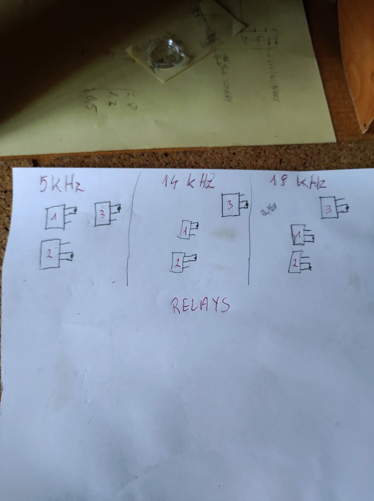

      Thank You for answer Ivconic. Yes relays nr 1 and 2 with those parrael caps are for changin Tx circut they are driven by U9 (74HC595D) and Relay nr 3 is for changing circut for Rx signal. I did earlier what You suggest desolder them and check, U12 is analog switch (TS5A3159) and Q2 double BC807 (BC807DS). I`m not sure is this transistor is main transistor in Tx circut, without schematic is difficult to track.. Relay connections with different freq. looks like this:

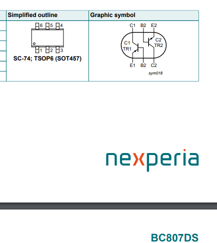

        BC807 can be a complementary pair Tx output, check emitters of them , do they are connected together ?
        Click image for larger version  Name:	image.png Views:	0 Size:	10.0 KB ID:	425973Click image for larger version  Name:	image.png Views:	0 Size:	25.4 KB ID:	425974Click image for larger version  Name:	image.png Views:	0 Size:	51.9 KB ID:	425976

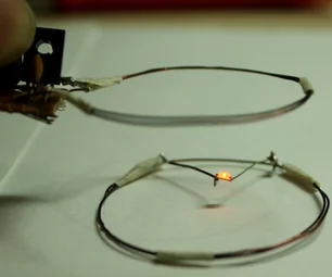

        I measured the amplitude of the Tx transmitter with a multimeter: = not good, multimeter is ok for 50 or 60 HZ not for kHz, you need oscilloscope or any coil with LED as a field strength meter.​​​​
        Click image for larger version  Name:	image.png Views:	0 Size:	885.9 KB ID:	425979​​
