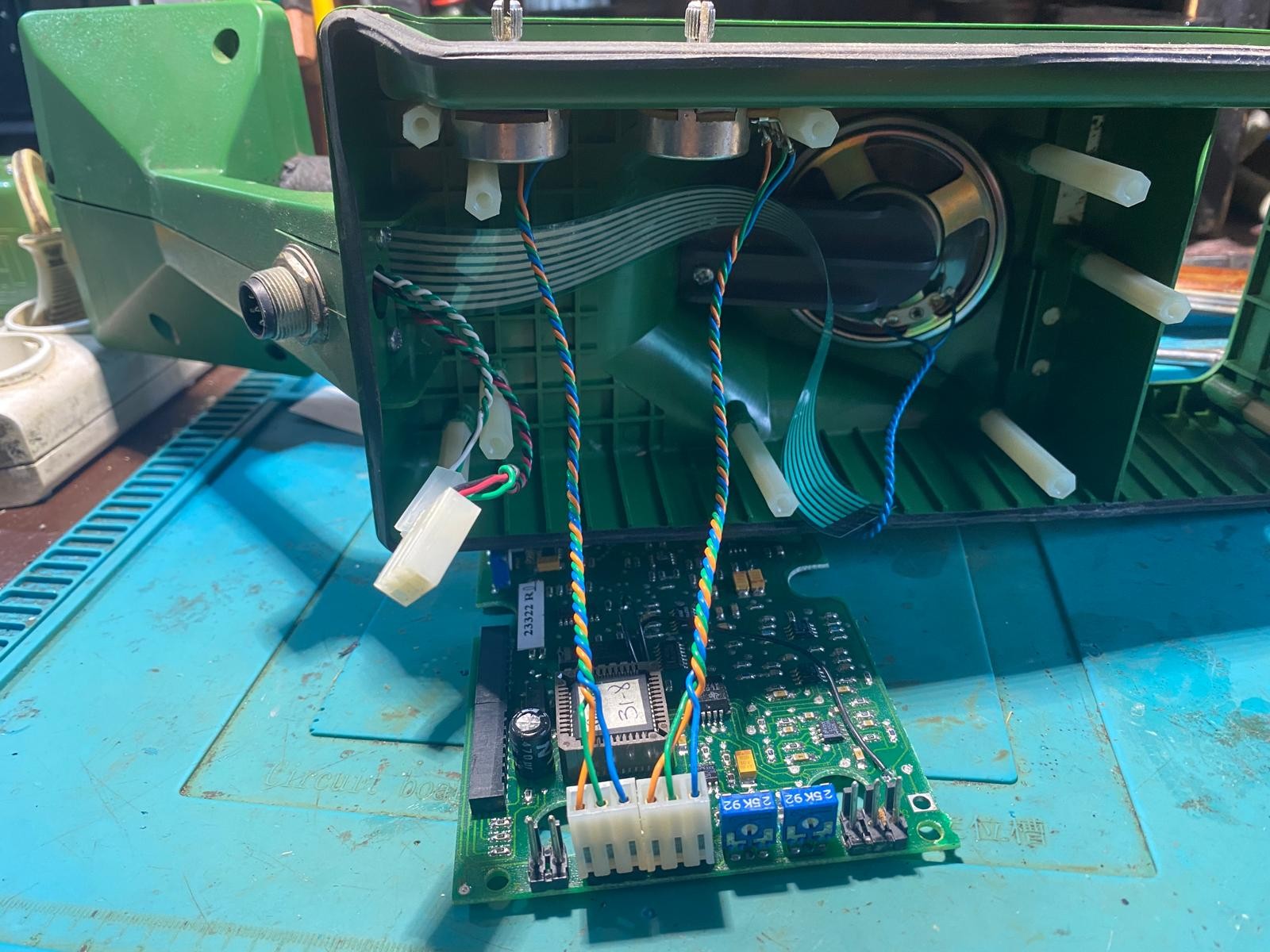

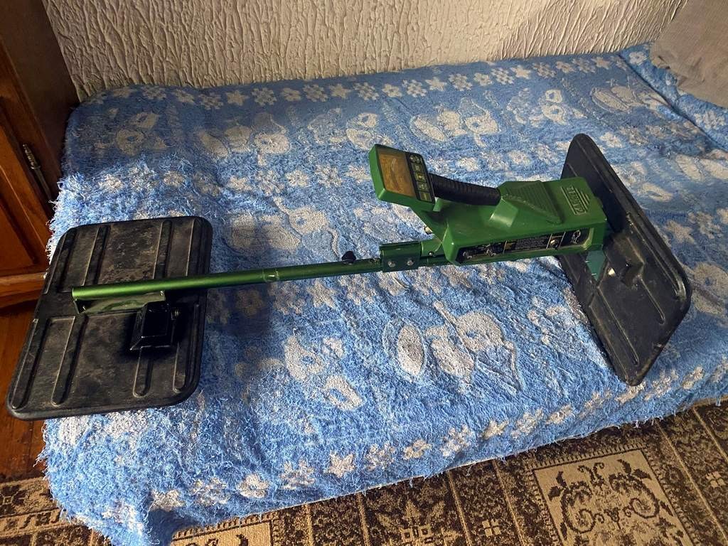

          Just got another Master Hunter CX to "service".
          The detector seems to operate, no visible problems.
          Problem is lack of the coils cables.
          So... I have to figure out how to make those cables.
          Don't have a clue!
          Is there a chance anybody to have and share pinouts for this one?

            I have a CX 3 in my workshop with the same titles. I'll check and share. But the receiver coil works in series resonance, so the right way is to find the oscillator signal by connecting an oscilloscope to the transmitter coil terminals on the back. While the transmitter is running, check the receiver coil terminals with the oscilloscope to see the signal. After that, it's child's play for you.​
              Ok, it can be done that way, but it's much simpler to just "beep" the cable with the buzzer on the unimeter.
              Draw the 3 connectors and the pins and just connect which pin connects to which with lines.
              Never mind the coils, just examine the cable and the wirements on it.
              Nothing simpler, right?

                    I looked at it today. I saw in the picture that you have a Crossfire coil in your hand. Look at the socket connection of the coil. Apply the same to the transmitter socket and receiver socket. They will all be parallel.
