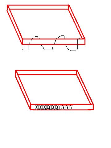

    Now, I see that it says "jumble wound". Does that mean that the coil wires are turned around the strip (Top example) or does it mean that they are just a bunch of little coils "draped" around the strip (lower example)? Sorry about my poor drawing.....

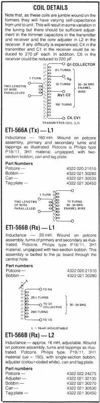

    I see, on every diagram, there is a "small" coil pictured to the left, and a bigger coil on the right, with a broken line in between. Does this mean that the smaller pictured coil goes "under" the strip? Also, why are there 3 coils pictured?

    I forgot to add a picture of the coil diagram

      The strip of aluminium around the edge of the wood is the coil. So there is one strip for the receiver and one for the transmitter.
      If you look at the diagram of the complete receiver circuit (page 6) you will see one loop (the receiver) at the top left, and another loop (the transmitter) at the bottom right. The square parts labelled "LOOP" are the aluminium strips. To add some confusion, the author has called both the RX and TX transformers L1, whereas these are actually two separate items. It appears the reason is that the receive and transmit circuits are considered to be completely independent, and therefore several of the reference designators have been duplicated.
      "Jumble" refers to the tidiness of the coil windings. i.e. they do not need to be wound neatly with perfectly overlapping layers. Just wind the wire on roughly until you have the correct number of turns. In other words, it's just a "jumble".
      The three transformers are each wound onto a potcore (Philips type P18/11, 3H1 material). The purpose of the two L1s is to provide impedance matching between the circuit and the TX and RX loops (aluminium strips). The third transformer is also used for impedance matching between the RF amplifier and the following stage. So there are no windings on the wood formers as you've shown in your diagrams. All the windings are on the potcores.
      Also look at the PCB component layout, where you will see 3 coils. The broken line on the coil diagram represents the ferrite core material. In the section entitled "Coil Details", the first coil connects to the transmitter, and the second connects to the receiver. The "small" coil to the left connects to the aluminium strip.

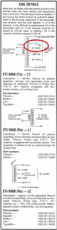

                In the picture below of the coil design, what does this mean (circled in red)? what does this tapping lead to?
                  It connects to the negative side of the battery.

                    The 3H1 core material has been obsolete for some time. It's replacement is 3H3. Although any material with similar permeability should work. P18/11 3H1 cores were widely used in telephone circuits.
