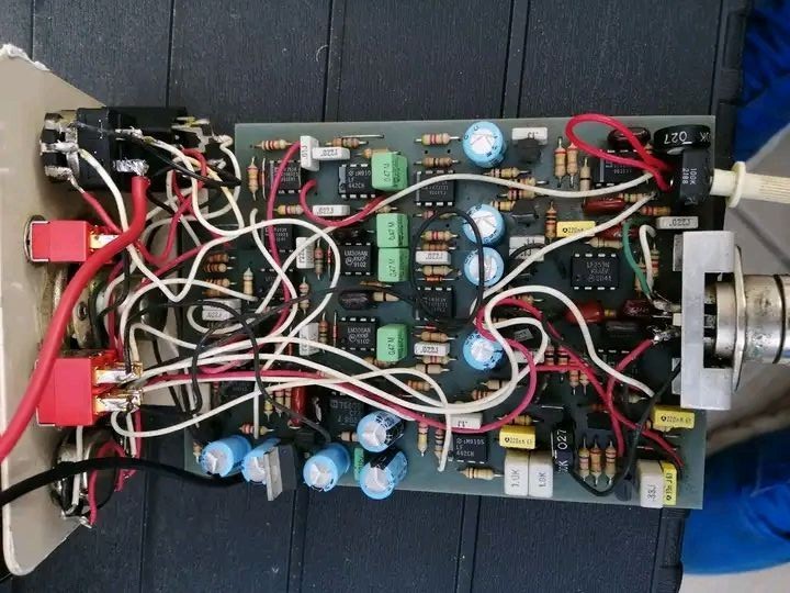

Tesoro Pantera
  • Tesoro Pantera

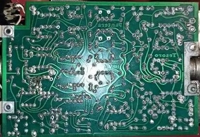

    original layout Click image for larger version
ID:	426549 [ATTACH]n426550[/ATTACH]
    GMT King Cobra revived?
      Nice work Dbanner

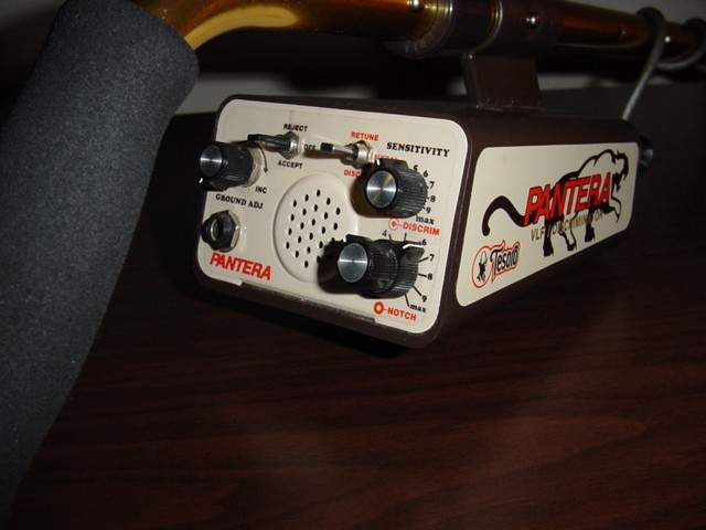

      I reversed a.Tesoro Golden Sabre in the 90's and the pcb was marked Pantera. I don't remember the Pantera being marketed? But Tesoro had a tendency to recycle their circuits.The Golden Sabre was very popular.
      GMT Cobra was a direct clone of the Golden Sabre promoted by Kellyco and the quality was inferior to Tesoro.

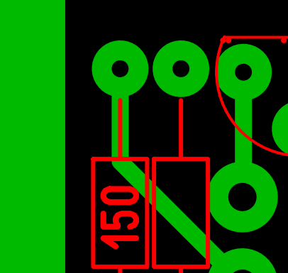

              sharp eye of ivconic never sleeps - missed connection of this resistor!!!

                What was the difference between the Pantera and Golden Sabre, external ground balance control?

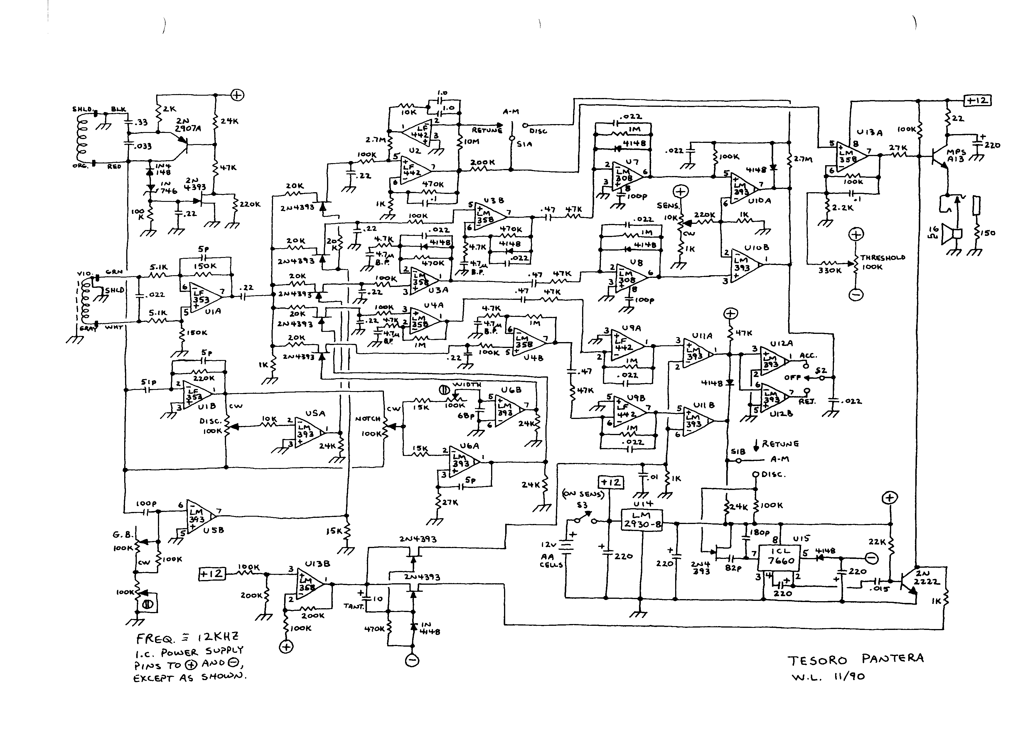

                    update Click image for larger version  Name:	FB_IMG_16981434295788140~2.jpg Views:	0 Size:	121.2 KB ID:	426576 Click image for larger version  Name:	FB_IMG_16981439584146036~2.jpg Views:	0 Size:	62.2 KB ID:	426577
                    the component on bottom left I do not know how it connects. It is not clear from the schematic diagram. Click image for larger version  Name:	Tesoro_PANTERA.gif Views:	0 Size:	139.9 KB ID:	426578

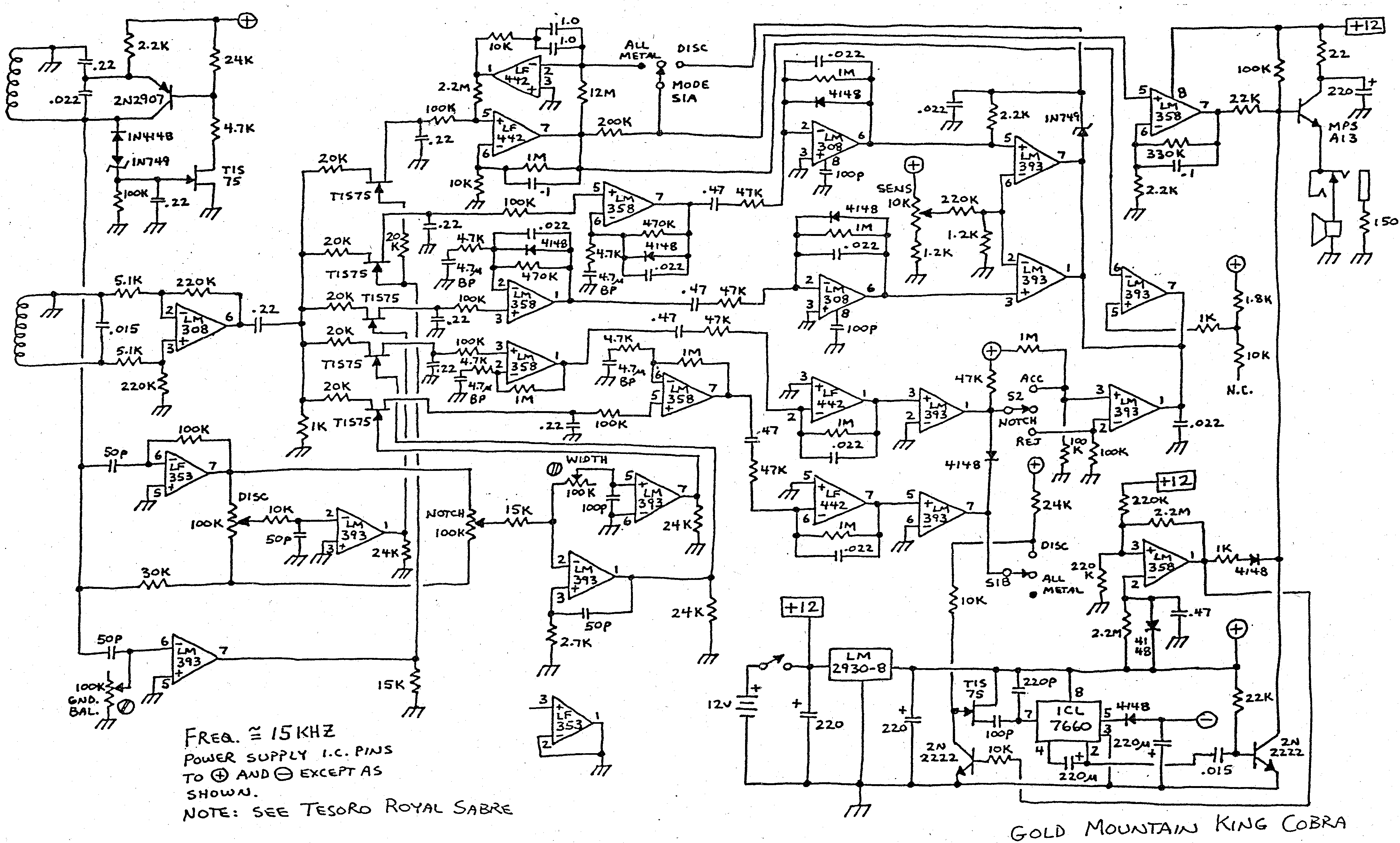

                      I put layout only for reference. Obviously not for making. It seems much the same as GMT king cobra. Click image for larger version
                        Here is the Cobra diagram https://disk.yandex.ru/d/kVLn7vlhExMzgA

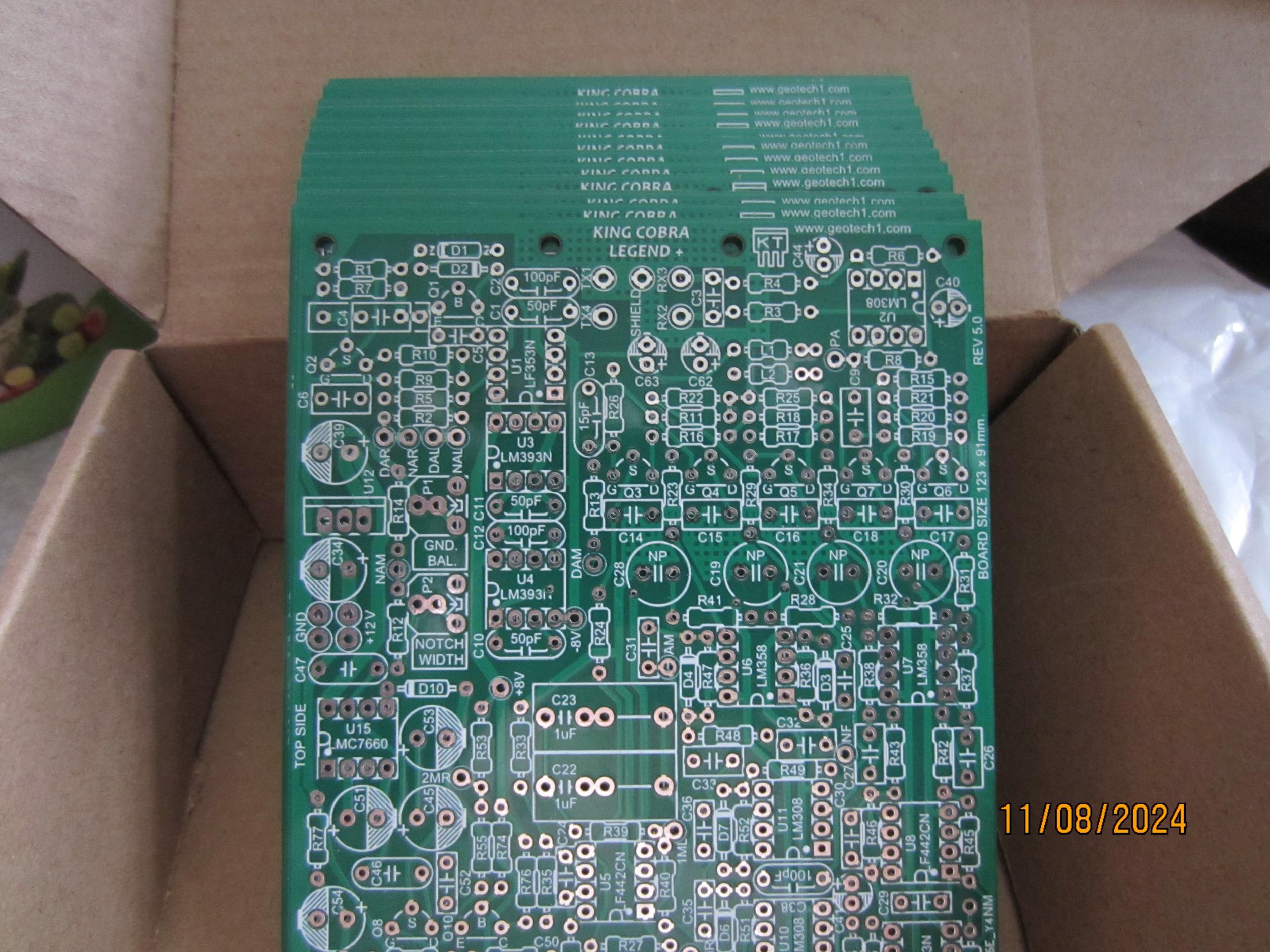

                            Click image for larger version  Name:	IMG_1843[1].jpg Views:	0 Size:	573.4 KB ID:	427202
                            I put layout only for reference. Obviously not for making. It seems much the same as GMT king cobra. Click image for larger version  Name:	King_Cobra_Lahr_sch.gif Views:	167 Size:	216.3 KB ID:	426581
                            i have the batch of pcb of GMT KING COBRA. 16 euro USD18 shipping included. no sharp need to redraw the pcb, you just waste your time at air.
                            had covered up tesoro-looking schematics on years ahead... no more reason to waste a time. just get-and-go project.
                            pleasure
