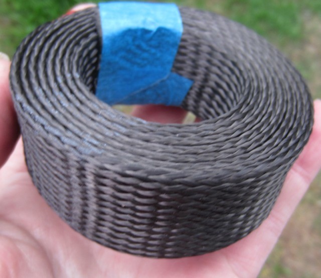

    Hi, recently finished a Surf PI with most of the mods( picks up a 9ct gold cuff link at 6 inches) and decided to check the carbon fiber braided tube I had from another project.
    Waving the braid over the coil triggered it at about 6 inches away. Its a 1m length of 25mm rolled up.
    Strangely it doesnt detect 5mm dia solid carbon fiber kite rods and a 500gram plastic bag of graphite powder is only seen on one half of the coil. (rhs when in general use position.)
    Does this indicate its probably a bad idea to swop out my current 20mm dia pvc conduit lower rod for a CF one?
    For what its worth, Im using a plain jane coil, 20 turns of 0.4mm enameled copper wire, 235mm dia, cable tied to a plastic plate( no shielding) and connected to the electronics with RG58 coax.(BNC 50 ohm connectors to make swopping coils easier.)

    There is a long thread on the DetectorProspector forums about carbon fiber lower rods:
    I got a very rare metal detecting surprise recently when I was informed of something I automatically never considered. Every detector I have with a cross hatch carbon fiber lower rod, screams with a Garrett pinpointer and even more so if I check that lower rod with my 24K. They told us back in th...
    It is mostly a problem for higher frequency detectors and mostly when the rod is folded against the coil, as when digging a target. A CF rod has a response very close to that of salt water and as long as there is no relative motion between the coil and the rod it is unlikely to cause much of a problem. Add to that the SMPI is not aggressive on low conductors, so I think a CF rod on the SMPI will be fine.

      Thanks for that, I'll go give it a read.
      Yeah, when kept still it goes quiet, just thought it might reduce depth, but its my first, so still lots to learn.
