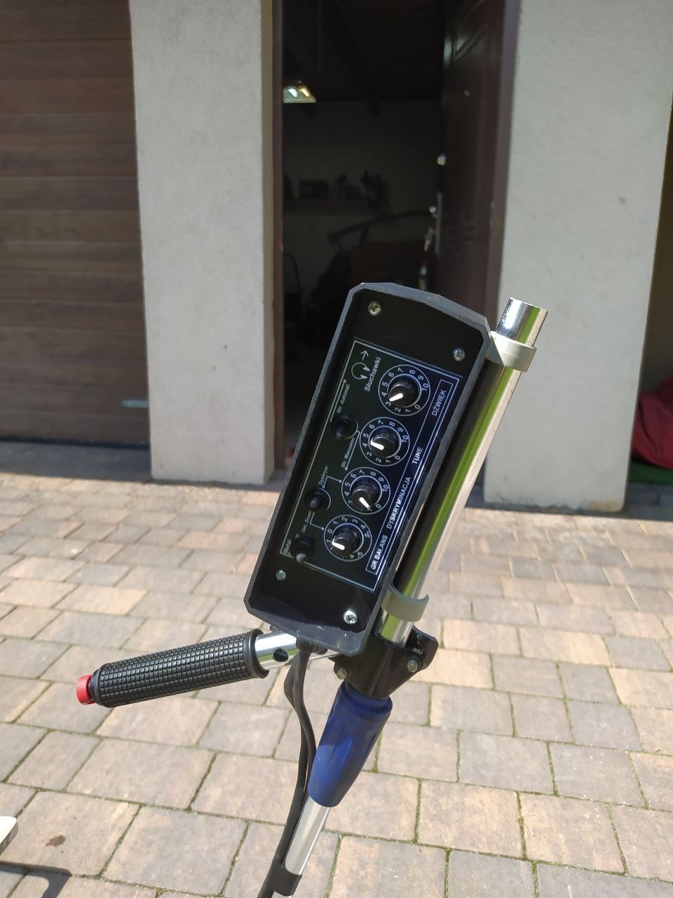

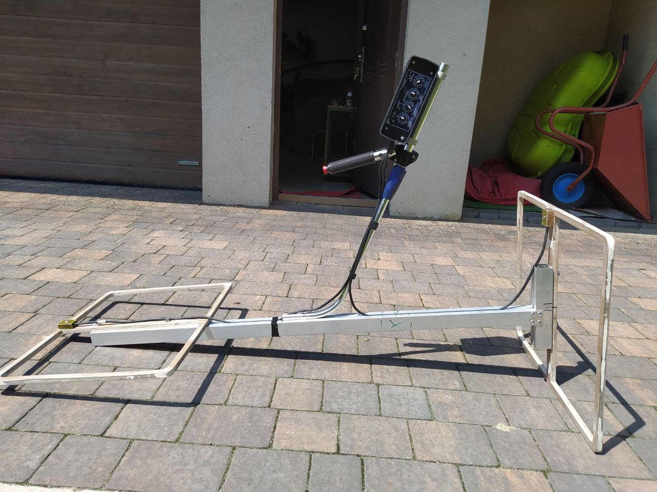

        Polski Smętek on steroids. No one produces it, made by yourself.​
        Click image for larger version  Name:	2021-07-07 14.41.59.jpg Views:	0 Size:	292.2 KB ID:	427406 Click image for larger version  Name:	2021-07-07 14.42.21.jpg Views:	0 Size:	164.6 KB ID:	427407
          Thanks guys. KT, I knew the TM808, and the similar TF models could be run in Cave/Trace mode to ignore iron, but the TM-808 does it by changing to a T/R type detection. I'm not sure how the TF models change to Cave/Trace. I wanted to stay in the same mode for all metal, but have adjustable disc. I'm still learning this 2-box/data logger system. Ivica....I'm laughing over that $12,000 price tag. Don't think that's going to happen if i want to stay married. Mario, I may look into building a setup like that. I'm familiar with electronics...was a radar tech in the military, but I'm not an engineer like you guys. I have to go really slow...LOL
