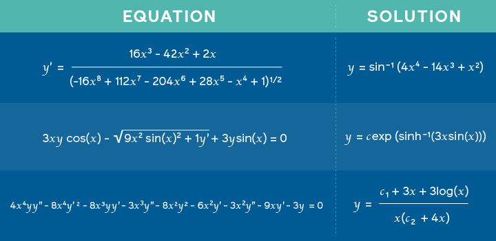

      You guys are looking at the wrong end of the stick …. The real application of neural nets and metal detectors is solving the complex equations
      Involved in the settings of the detector. For instance when you adjust the ground balance control your meat ware in your head is “solving” the ground balance equation implemented in the detector.
      If there’s a whole bunch of controls … parameters if you like … the NN adjusts these better than you could and converges on a solution that might be maximum target signal or target type or optimal ground balance etc etc.
      eg the solution to these equations were found by a NN but could not be solved by matlab.

        Yes here parameter optimization, ground balance or ground tracking can also be based on the model.
          Makes sense.
          I completely misunderstood the idea, my fault.
