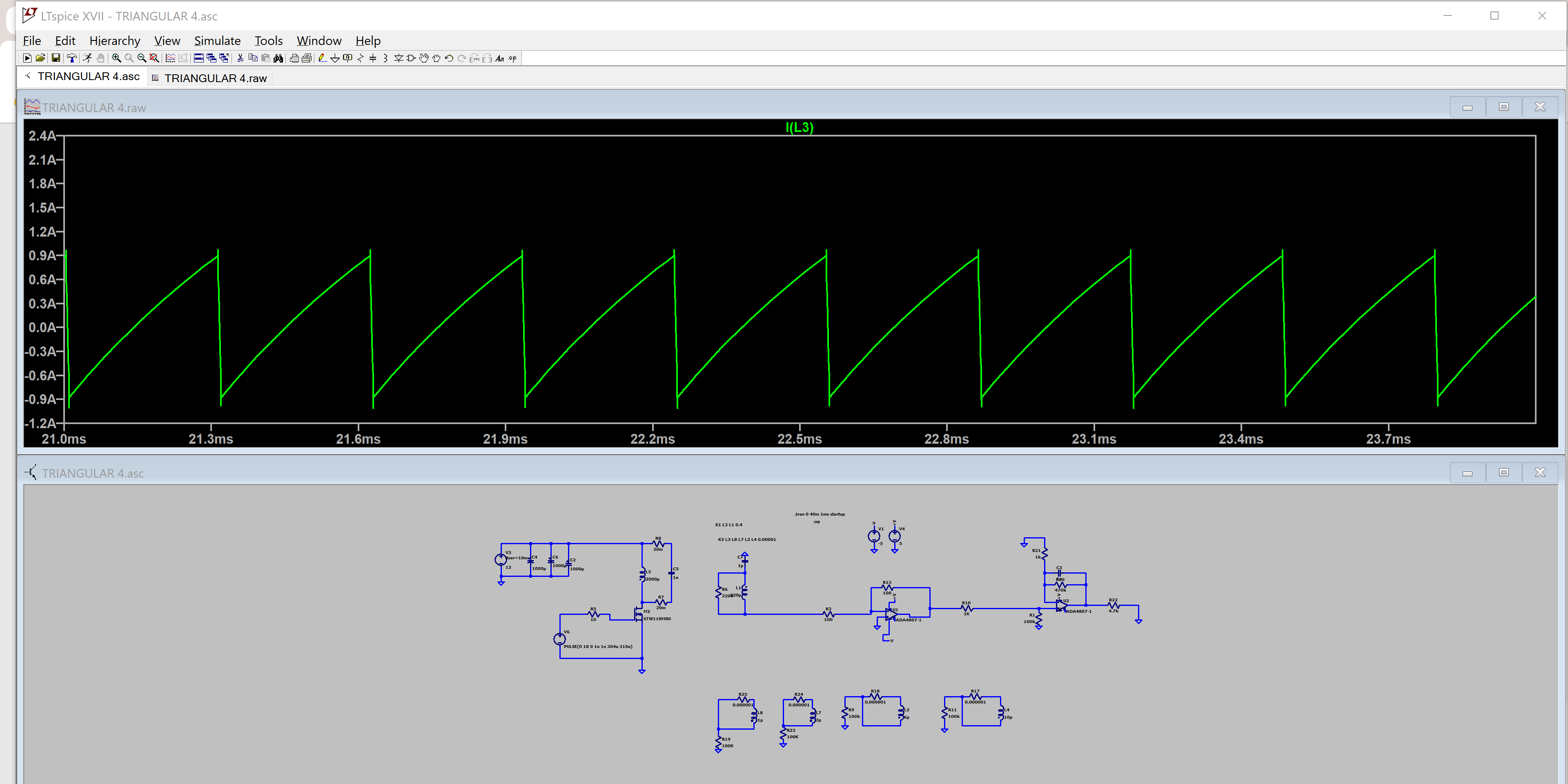

    What are the classic design specifications of a hybrid PI detector? Is there any information that defines a hybrid PI detector?
    For me, a hybrid detector is one that combines a PI (transient step) response with a reactive (VLF-like) response. There are different ways to do it including half-sine, what Voodoo does, and even using an IB coil in a traditional PI design to look at the TX-on response.
      Here is one more Hybrid. Very energy efficient and powerful.
        TRIANGULAR 4.zip
        And here is the LTSpice file.

          I would start at the patent ... US20110316541A1

            What is the schematic for this hybrid MD with these TX waveforms?
